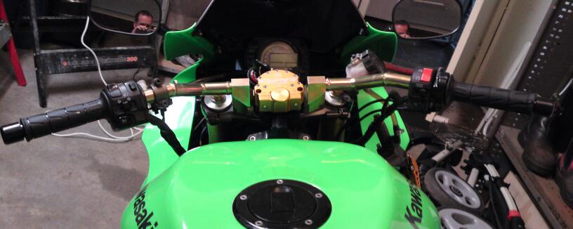

greenman43 wrote:Thanks Glen, much appreciated. Wondering now if it might be better (read : significantly cheaper) to adapt some risers to the standard top clamp - hmmm ...
Cheers,
Brian
id say thats the go ;)

After doing this same conversion on the MFP12 last weekend.....all I can say is that it is farken sensational !! Comfortable and really easy to ride - feels like the Black Pearl on steroids ..... 8)
4th Dimension Products (TM) - total cost $0.00
Brian - you can adapt a set of bar-clamps from any old MX bike - I used the stock clamps from the original YZ500 top triple clamp. Drill 2 holes, make 2 long bushes for underneath the top clamp - and bingo, instant mounts.

I love my bar's conversion.
