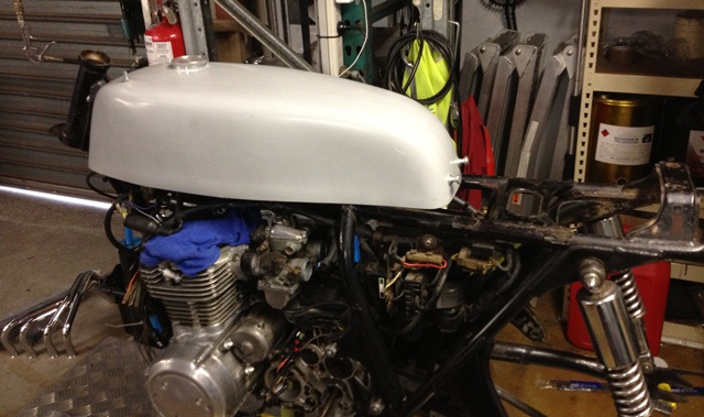

robracer wrote:Kev there are a few places doing them in the UK & the US
http://www.discovolantemoto.co.uk/
http://www.airtech-streamlining.com/vin ... etanks.htm
or Alloy tanks for the unlimited budget, but they are quiet reasonable considering what they are:
http://www.holtworks.co.uk/contents/en- ... tanks.html
Lots of choices :D
Thanks Rob

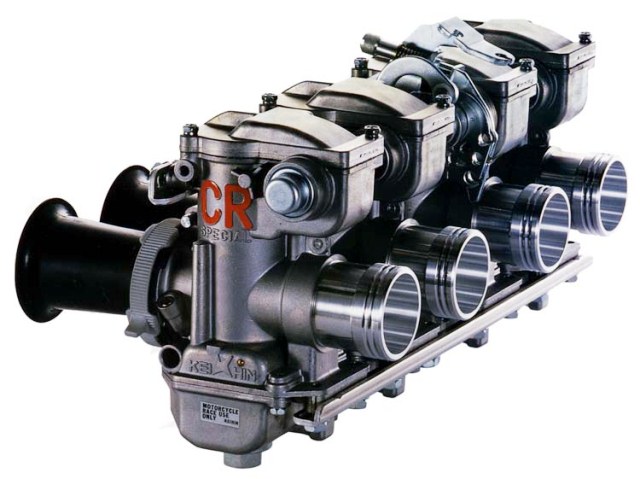

Strip down of the original carbs....... what a mess, even with the spare set I have I am not going to bother with them as they probably wont handle running on Methanol, but these smothbores sure will 8)

Re: Going racing again!
you gonna cam it up a bit mate ? those Keihins look the biz :kuda:
searching for a suitable Cam, Scotty is on the case ;)

Are you wrapping that tank in carbon fibre?
