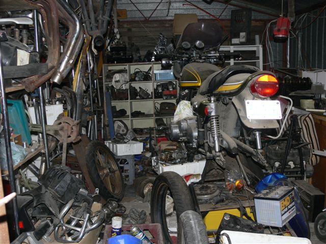

Road Trip 192.jpg (85.56 KiB) Viewed 8295 times
the kid wrote:Don't Do It
But hang on, the bit I'm after is just over there, behind that box of bits...if I just slide past this frame, stick my arm around those headers, and brace my leg against this engine case, I can just about reach...........
