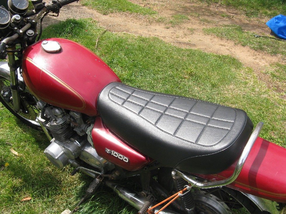

Here's the seat

Re: okay, let's get it back on the road.
Looks very tidy - 6 kudas !
Yeah, was pleasantly surprised by the quality and look.
