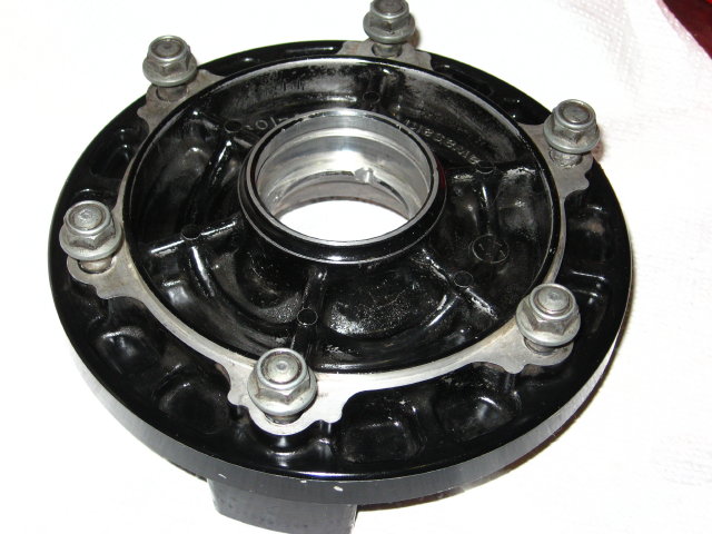

javaman wrote:So what sort of bearings are you replacing it with? Same type or the regular ones from bearing shops?
I have a conventional 6006 deep-groove ball bearing (same dimensions, 30x55x13) waiting to go in. It is of the rubber sealed on both sides.

I was considering giving the sprocket carrier a shot of black paint before it goes back on, but as it seems to be painted with something similar to the engine, it occured to me to hit it with some S100 Engine Brightener instead.
Before EB. The sprocket carrier is not perfectly clean and probably never will be.
After EB:
It seems to have improved the look.

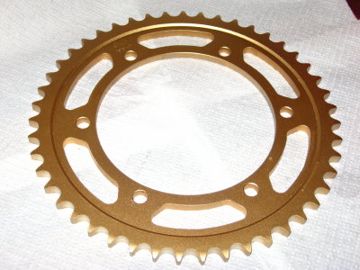

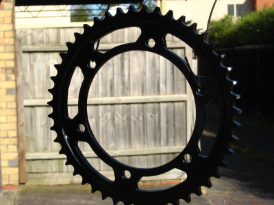

I had painted the new rear sprocket gold to match the new goldy chain:
Bling!
Bling!
I umm'd and ahh'd for a while and decided to go with basic black instead:
Black is the new black. How did people paint stuff before coathangers were invented?

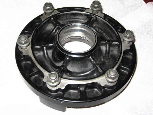

The new sprocket carrier bearing should be a breeze to replace next time, if needed.
Perhaps a future owner will thank me:
As seen from the cush drive side

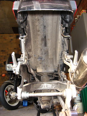

29 years of somebody else's shit to clean up. Looks like next winter is sewn up. Oh well, there are probably too many tourists in the Bahamas that time of year anyway:
I may well be a dirty old man, but I don't want to ride a dirty old bike

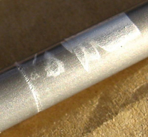

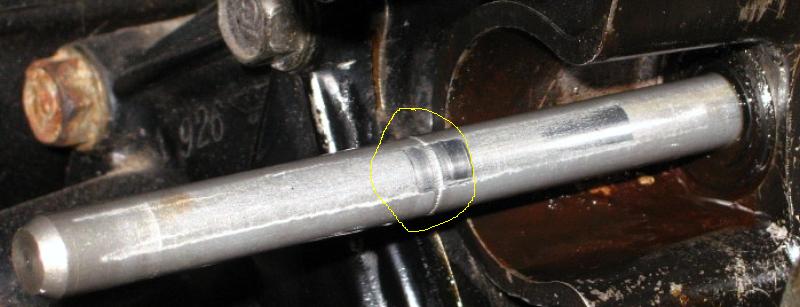

While I had the front sprocket cover off, I figured it would be a good time to clean the shit off the clutch pushrod to give its seal a better chance of survival.
Just as well.
When I slid out the pushrod, I found a groove on it, right where the seal lip sits. Fark Orf.
I expected some wear from lots of sliding in and out but not the groove:
Maybe this is Kawasaki's answer to the ScottOiler
Let have a look from another side and a different angle:
Not cool
Not cool
Luckily for me, Kawasaki made the pushrod quite symmetric so all I had to do was clean it up and flip it around so that the groovy end is inside the engine, giving the pushrod seal a better surface to work with.
While I was having a smoko I gave the bike a maintenance startup and by golly that pushrod does like to spin from the oil drag. That would have an affect on the seal in the long run as well I suppose.

That's a similar setup to my GPz.
How is that push rod grooved like that as they don't rotate (?)
Re: GPX750R resurrection
Posted: Sun Nov 27, 2016 7:57 pm
by Mister_T
javaman wrote:How is that push rod grooved like that as they don't rotate (?)
Mister_T wrote:While I was having a smoko I gave the bike a maintenance startup and by golly that pushrod does like to spin from the oil drag. That would have an affect on the seal in the long run as well I suppose.

The oil can spin the rod? Interesting, what would have caused it - leak?
When I took mine out it was mint and smooth. I had to be a bit paranoid too which side goes to which (they're the same!)

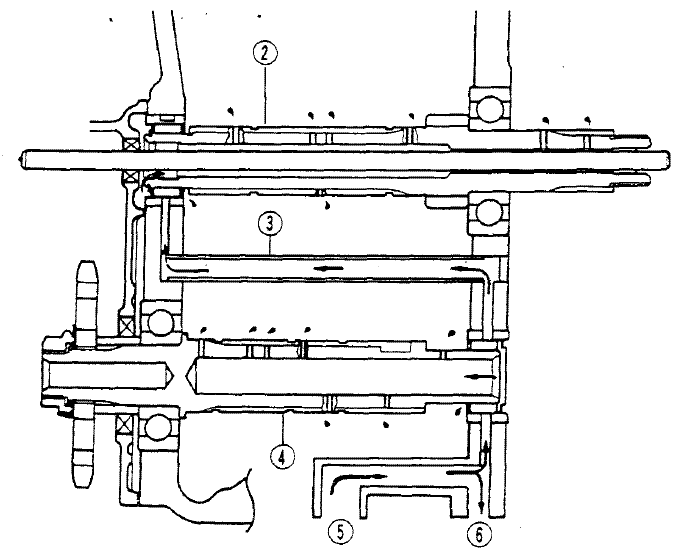

Posted: Tue Nov 29, 2016 12:54 am
by Mister_T
Oil flow or gearbox diagrams for the GPX will show a lot of oil running through the shafts, they need it.
The pushrod runs inside the first motion shaft.
The first motion shaft is driven by the clutch.
Lots of bikes with a hydraulic clutch would be like this.

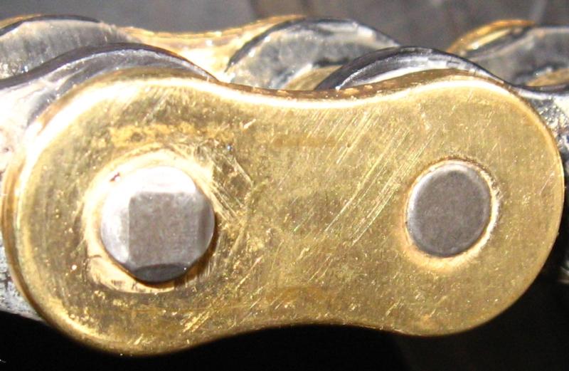

Got the new chain and sprockets on and only briefly enjoyed that unique feeling of new chain and sprockets when, after a brief test ride, I stood back to admire my handiwork and noticed this:
The short pin does not look like riveted head has broken off, it does not look like it was ground down to shorten the chain and was done wrong (the chain was supplied with the spec 110 link length), the pin just looks too short, like it might be from a 520 chain instead.
I checked the other side of this link and it looks correct. I then checked all the other pins on both side for more like this one but there are no more.
Just as well I installed the chain with this side facing out.
I won't wave my arms about and name names and cast aspersions until I hear back from the supplier.

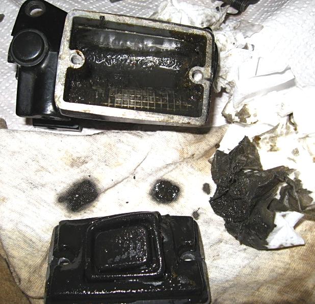

It could have been a nice day for a ride here in Melbourne today, but I chose to do the clutch hydraulics instead due to a minor drip from the clutch master when in use.
I know clutch hydraulics tend not to get much attention, but even this surprised me.
Geez, where does all the sludge come from?
No frikkin wonder it started leaking

That's much worse than mine. Mine had this red-blackish particles. I had to flush it three times to have a clean hydraulics.
I read somewhere that those black particles are actually rubber from the hose
