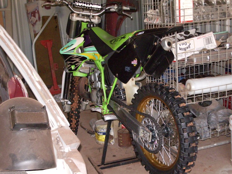

>>> Below is a factory produced weapon for those who aren't into dirt squirters -- At the time the KX250(this one) was a weapon not for the inexperienced and then the KX500 (for mad farkers like Gos!!) 2 smokers were two of the nastiest dirtbikes around!! ..... Add another 100 or so ponies and a lot more attitude and you have what this thread is about :shock: :shock:
plenty enough for for this black duck!!
My98 KX 250.jpg (166.98 KiB) Viewed 6334 times
Well done guys ... farkin awesome effort 8) :kuda:
