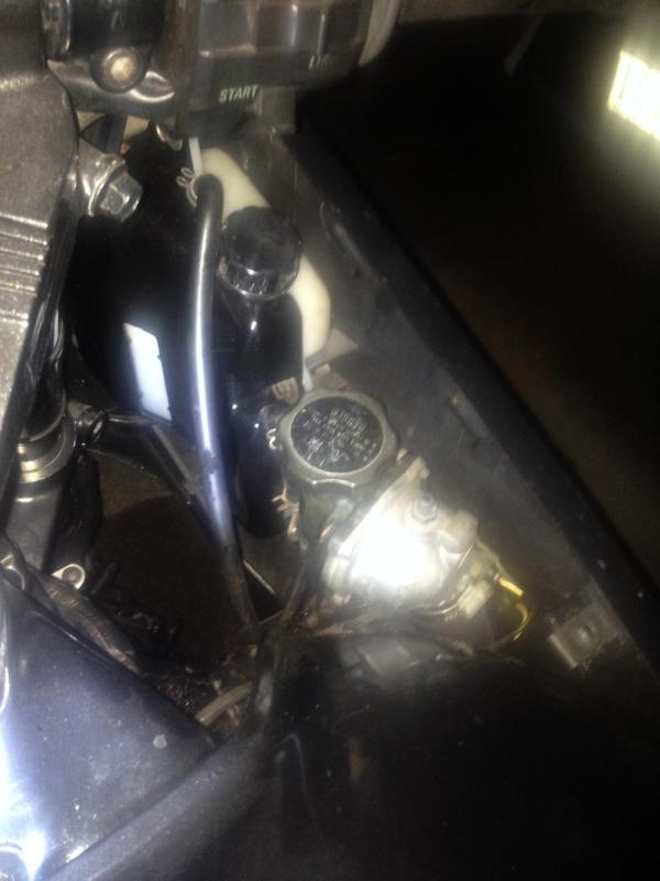

Changed the coolant on the weekend. More rust came out than I would have liked. I tested the old coolant with some test strips I had lying around and it tested good. The test strips were somewhat out of date but I sanity checked one of the strips from the batch with some pure water and got the results I expected. New test strips and kinda pricey for what they are.
By the book, the coolant should be changed every 2 years. That means by now the coolant should have been changed about 14 times. I doubt that has happened.
At least the surge tank and the filler and bleeder are easy to get to, sited up in the right fairing so there is not much excuse not to. The cooling system only holds about 2 litres so it is not an expensive task, either.
I wish the surge tank was easier to clean out. You would think a product like CLR would get the rust out easily but I guess there is too much other stuff inhibiting it. No pics of the process. Cooling systems are wet and messy and not conducive to handling electronic gear along the way.
The temp gauge reads lower than I would expect. Running temp is about 1/3rd up the gauge. The fan cuts in before 1/2 way up.
I'll have to see if there is a volt reg in the gauge cluster for the temp and fuel gauges.

Re: GPX750R resurrection
Post by javaman »
Where would the 'rust' came from? Aluminium don't rust do they?
I need to do/improve the cooling on my GPZ900R. 15 min in any traffic and it goes to the red zone. Have drained, change cap, etc. Which is funny as my aircooled 750 can sit in traffic all day no worries :?
-ariel circa 2007
http://GPZninja.blogspot.com/
Mister_T
Posts: 205
Bike: GPx750
Post by Mister_T »

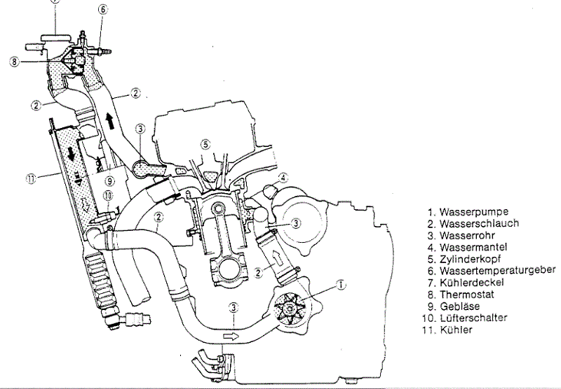

javaman wrote:Where would the 'rust' came from? Aluminium don't rust do they?
Ally does not rust but it does corrode.
There is still quite some ferrous material in the GPX cooling system. The GPX uses "wet-sleeve" cylinder liners (with a "closed deck" cylinder block) which are directly cooled by the liquid. The in and out water manifolds on the cylinder block are steel. The waterpump impeller and some thermostat parts may be steel but plated to reduce chemical activity. There are steel bits in the pressure cap. The coolant pipe between the lower rad hose and the waterpump inlet is steel.
I guess the GPz900 would be mostly similar.
The corrosion inhibitors in coolant not only restrict the unwanted interaction between the differing metals in the cooling system, they are also supposed to stop the ethylene/propylene glycol from attacking stuff as well.
javaman wrote:I need to do/improve the cooling on my GPZ900R. 15 min in any traffic and it goes to the red zone. Have drained, change cap, etc. Which is funny as my aircooled 750 can sit in traffic all day no worries :?
Does the fan actually come on? If the fan is ok, the thermostat might not be opening enough or is stuck in one spot.

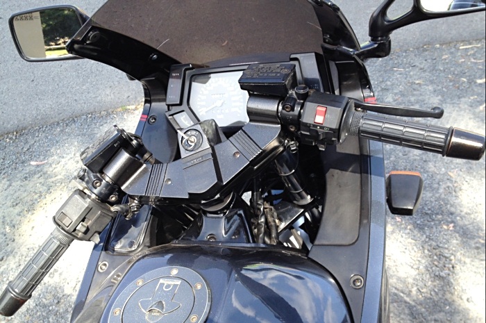

I fitted some nice new OEM grips to replace the skinny Ariete grips the bike came with. The factory grips are thicker and softer and feel better, plus they give the bike a more original look.

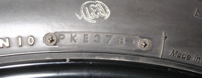

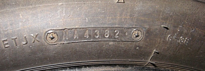

I got mildly curious about how old the tyres are. They are nothing flash and don't have any visible cracking or crazing. The only time I've had a slide is in some loose gravel on an apex on the Mt Dandenong Tourist Road.
Going by the 3-number DOT code, the front tyre appears to have been made in the 37th week of 1998. It won't be too long before the front tyre qualifies for its own historic rego.
The rear tyre's code has me perplexed. The 4-number codes were supposed to have come after the year 2000, 3-number codes were apparently pre-2000, so what does this code on the rear tyre mean? Am I reading it wrong?
The_Fixer
Posts: 32
Joined: Sat Dec 02, 2017 7:47 pm
Bike: GPz750
Post by The_Fixer »
Tyres have a use life of 5 years, no matter how they look. I think this is also a roadworthy rule too, but not sure about different states rules.
Tyres may also be prone to catastrophic failure past this time frame, something not very desirable particularly a front one on a bike.
My bike (GPZ 750) has been sitting for over 5 years and the tyres still look okay, but I will be replacing them.

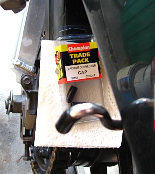

Ever quaked in apprehension when a concours judge looked at your GPX luggage hooks and noticed one (or heaven forbid, more) of the plastic end caps missing, then muttered an obcenity then scribbled on his clipboard? End your resulting wailing and knashing of teeth with some cheap vacuum blockoffs you can get at places like Bursons or Repco or Supercheap.
Sure, you might get the genuine parts overseas for a few bucks each plus about 59 fucking bucks for fucking "postage and handling", but these little beauties will see you through unless that damn concours judge is carrying a digital vernier gauge because these vacuum blockoffs are just little bit shorter.
Cheap and cheerful
Cheap and cheerful

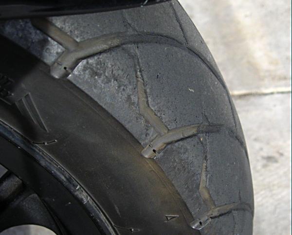

The_Fixer wrote:Tyres may also be prone to catastrophic failure past this time frame,
Suits my riding style then.
Not much tread left in the middle of this Bridgie BT17F but still plenty left to exploit on the sides.
Still deciding what to replace it with

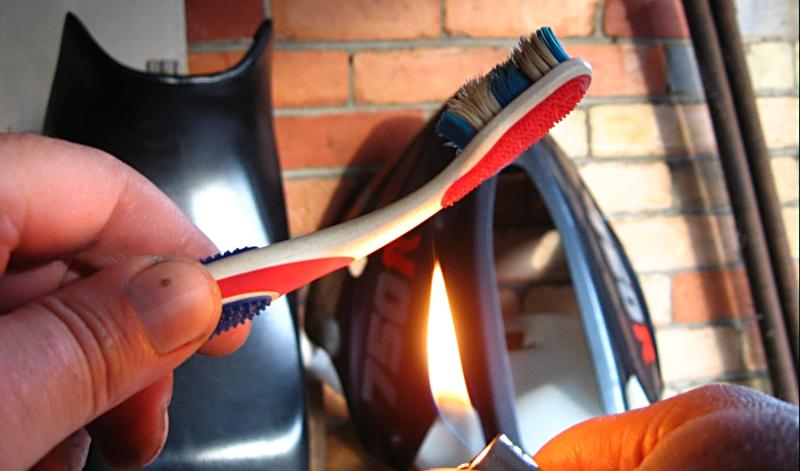

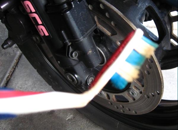

What has this toothbrush done to deserve this? It is worn out and about to become a customised cleaning brush for the bike and parts thereof.
Toothbushes are made of thermoplastic which means they get soft with heat. Use a heat source to make the plastic pliable and bend it to whatever angle you need to get to that hard to reach dirty spot clean again. Clean a chain, clean a caliper, whatever.
Rotate the toothbrush while heating for even softening. If you get smoke you are not turning it fast enough or have the lighter too close.
Ready for duty.<br />The camera preferred to focus on the bike and its exotic anti-dive technology which is understandable.
Ready for duty.
