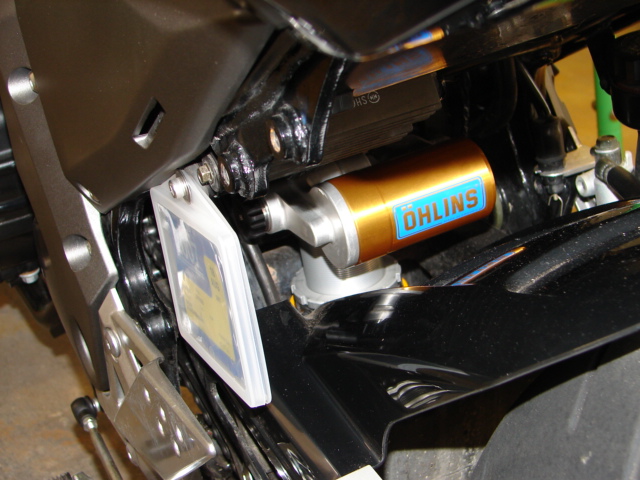

Hi Ian...Yes the 636 will work & the change over time is less than 15 mins as long as you can jack up the bike without using the swingarm & if you can find one that's in good nick (note.... rebuild it before fitting)
This Ohlins was just over 1K & is not top of the line but does an excellent job for the bucks but frankly the front end needs more work than the rear if you want the bike to handle
