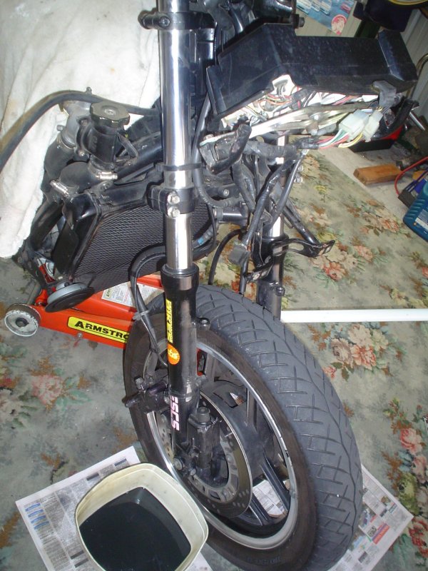

as a previous GPX owner...I have to agree with Mikemike-s wrote:Well when i had a GPX i put a four into 1 formula-1 system on the bike. It improved performance quite nicely and gave it a nice purr and didn't really need any rejetting or anything. But i put in a dynojet kit anyway to see if i could get an improvement in economy &/or performance. It was possibly a waste of time with the gpx ( i ended up using stock jets and putting the aftermarket needles, springs and other modifications in the carbs) but i was always chasing the purring perfection i could get out of her.[/url].
a can.... and headers (4-1 works well)
I did no rejetting but I did get the cams 'set' when I had the cam chain replaced
the other thing that works well..is a new foam air filter
other than that there is not much...make sure you replace the front fork oil regularly
with a slightly heavier oil...10W. You will probably find whats in there is..........
