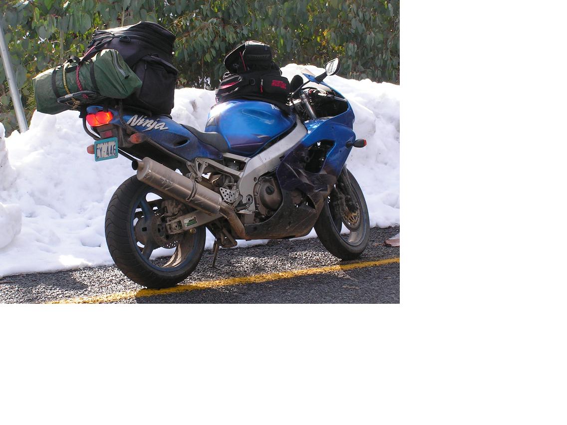

Post by mick_dundee »
Humm well fair to say it was fairly cold... and I regularly do over the 8k frog, perhaps not up Mount Buffalo though.
