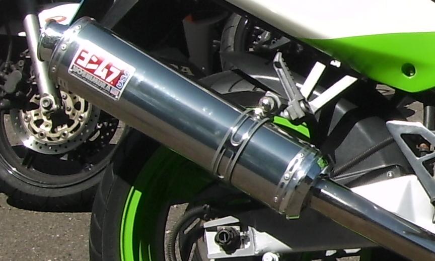

I would say it will go real close, my bike is like this:
http://www.asl-testsite.co.uk/motors/no ... 0-1992.jpg
And here's the manual for fitting the '96 on can:
https://www.yoshimura-rd.com/images/pro ... X729SO.pdf
The strap is a separate part so if it needs to go forwards or backwards that's no biggie, my only concern is the bolt pattern where it bolts to the header pipe I guess. The copper o ring gasket is the same part number between my bike and the ones this Yoshi is listed to fit.

Bogan wrote:There must be a reason they only list it for '96 on, but the price could be good enough for me to try to make it fit somehow?
Well it turns out that for anyone who's interested all I had to do to make it fit was take a file to the bottom hole in the flange at the back of the header pipe for about 30 seconds and slot it out a poofteenth of an inch. Bolts up bewdiful now and looks great. Exchange rates are being kind, and I got a good deal on freight, but if you wanted one I'm guessing it would still be cheaper than buying local even with the regular freight charge.

Jonno wrote:Cool, I was just thinking of this the other week for when I put together the 89', thanks for the heads up Bogan. 8)
Not sure about H but it fits nice on the J. Have a look at some online fiche websites and measure up the holes in the flange would be my suggestion.
