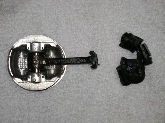

I have 2 ZX7R race bikes and I am on my 3rd motor. Generally they are fairly reliable except if they have fallen over on their left hand side and had the motor run for a little bit.
The No3 Rod/Big end is the most susceptible part to oil loss. Also try not to 'over rev' the engine as the No3 starts to starve of oil.
Handling wise the 7R is rock solid and some say to have an awesome front end.
I am currently (re)building a 793cc engine for my No1 race bike. Have a look at my site http://www.bigmitchracing.com
Piston Broke
Piston Broke
