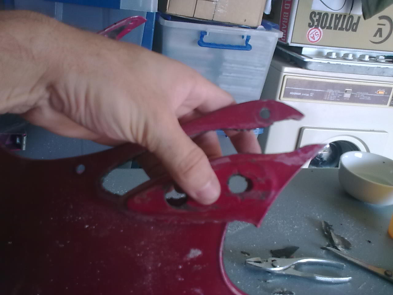

Ok well this is how it looked before, but it's had a couple of stationary drops from a certain learner ;) since then... but even so if you look closely you can see the duct tape holding on the front guard, and the clutch-side mirror is barely attached at all (dodgy fibreglass job)... so the aim is to fix these things up.
Re: Our little painting project
If in doubt with fibreglass, tear the stuff right off, sand back to the plastic & start again! I've seen some jobs and by god they are just horrible!! I haven't seen my old GPX since i sold her, but i imagine the glass job under the front guard and in the bellypan is still holding up spectacularly, given the thorough job i did to make sure it would last a long time (it lasted the 18 months i had her after those repairs without a single problem).

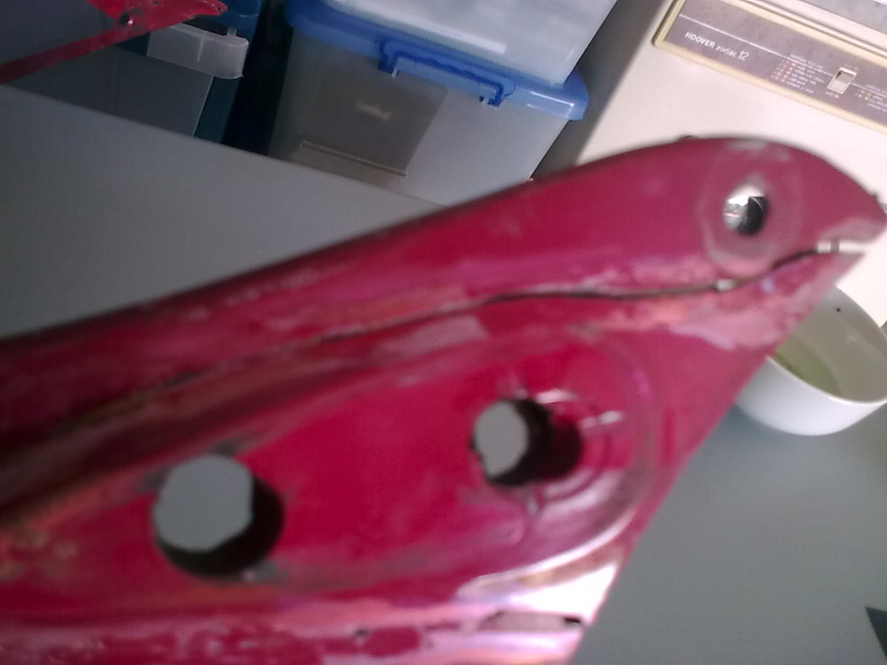

An example of the great existing fibreglass work is attached... as you can see it's a fantastic finish :lol:

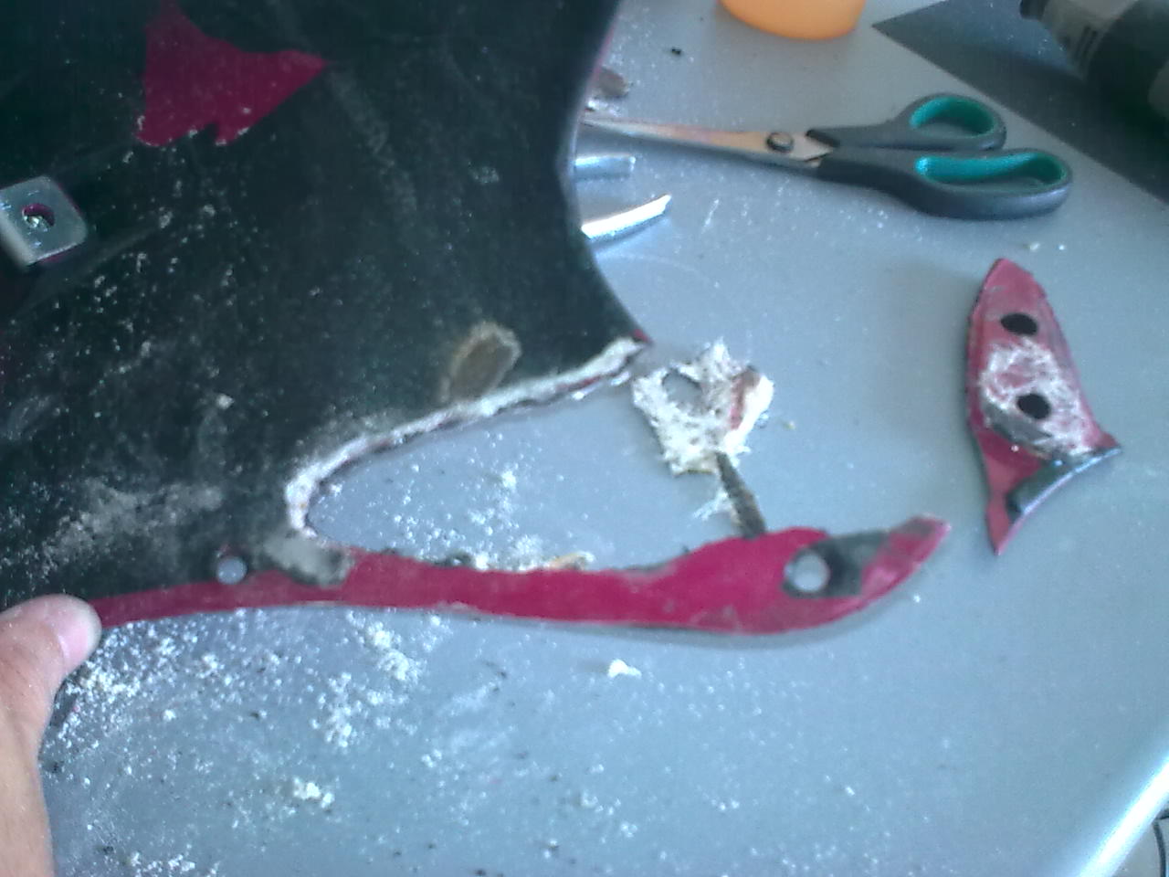

So I ground back all the fibreglass (note: wear mask! that shit is nasty!), which separated the part that was actually completely broken off, and started from scratch.

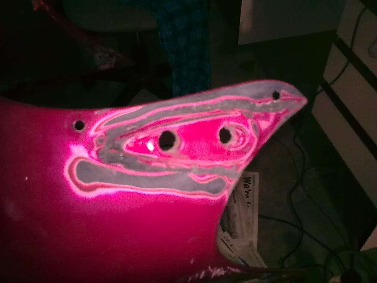

After considerable effort & plastic welding, I have this!

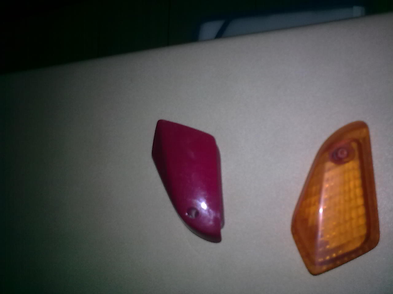

I'd always wondered where you get those indicators that sit in the tail fairing... as it turns out, they're just painted over!!
A bit of time with some sandpaper and they came up a treat.. just need to get some 2000 onto it.

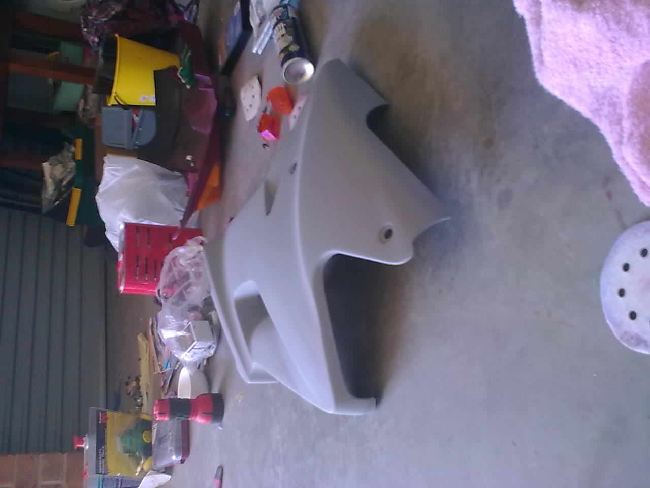

Pic 1: Lots of tedious and fiddly little bits need to be addressed with patience...
Pic 2: Starting to feel like I'm making progress now that a lot of the parts are in primer... although you'd be surprised how hard it is to find a shop that has more than one can of grey plastic primer in stock :roll:
