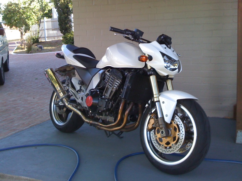

Here are some colour examples too ..
PEARL WHITE

White looks hawt!!!!

gotta love ya white!
My mate got quoted $1800 for his R1 to do a full pearl white resprey! so $2000 is generous! That price was from a few pro's in our area so no doubt if you goto a reputable bodyworks place they will quote you somthing similar. However the less work they do the more you save, so if you got time and skills rub back all the original paint and give the bare plastic to them!

IF you brought me fairings that far scrubbed back, you would be adding around 300 - 500 dollars to the job for me to get them primed properly ...........the paint only needs to be flatted back to provide a key for the new paint.
Flat black............. do you get free sticks of chalk ???
Pearl white looks really good, but trying to paint a pearl at home is not a good idea, as the humidity in the air really affects the paint causing "blooming" ..........That's why for a "good" job you need a paint booth ;) PLUS I'm STILL sweeping up the Acrylic "Overspray" from when Gavin did Dan's raceglass :roll:
