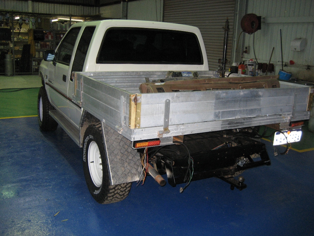

Some more pics ; (OK I'm a proud father alright - get over it! LOL :lol: :lol: )
Tray and sidesteps on

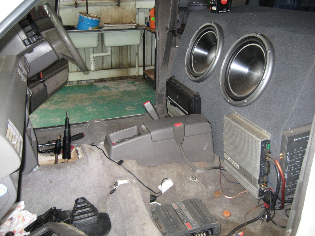

Spagetti city!!
Spagetti city!!
Towbar , tray and guards
