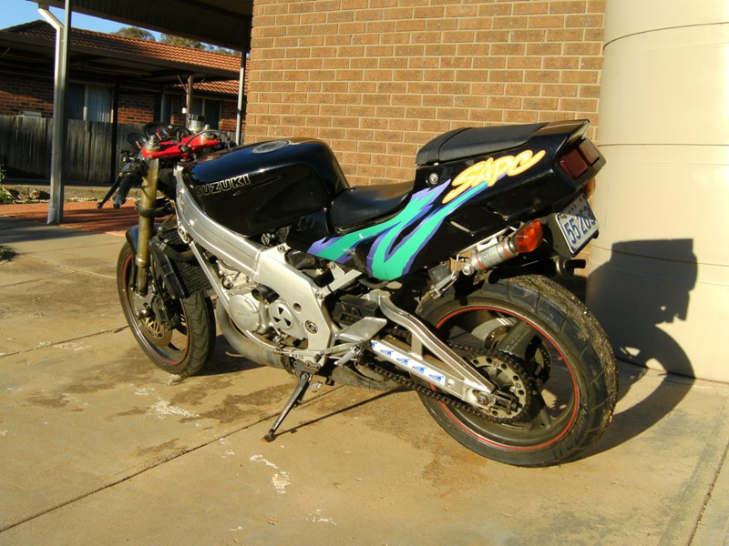

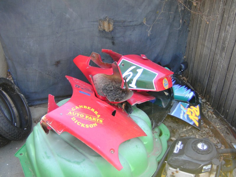

Duplication on the internets is wonderful, I feel a little bit dirty but here's my new toy (this is the 4th forum I've posted it in).
Picking it up shortly for a tracky, comes with the rest of the street fairings, full set of race glass and a few other bits and pieces.
Watch this space. Budget bike but want it to go fast on a budget :). Don't wanna spend too much on it, it's a Suzuki...

Is the lawnmower engine part of the deal?? :) :)
Sounds like a fun little project.
Re: The RGV
Posted: Fri Mar 20, 2009 12:55 pm
by MadKaw
I think the sealer was probly the clam shell sand pit...
I guess the lawnmower engine is a spare..
Re: The RGV
Posted: Fri Mar 20, 2009 1:05 pm
by Bogan
Absolutely, you can never have enough clam. And I think the mower is 4 stroke it's no good to me.

More pics, it came home today W00t!!! Have to do a bit of routine maintenance and inspection, then put it on a weight loss program, put the track glass on and go ring a ding dinging on the track somewhere soon :).
