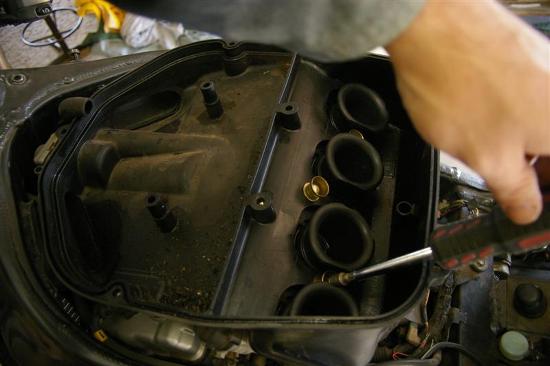

Removed the airfilter today on my way to get to the sparkpugs. I will be taking the oppertunity to remove all the bug guts from the airbox while its off (see pic), also clean out the filter while i'm there. Shame i don't have the money this week to put in a k&n replacement.
Took the carbies off to have a look, i like to pull things apart and i understand them better if i do so. I took two of the four apart to look in the float/bowl and they were spotless (with a quick examination). when i went to go to the third i had a rather stuburn screw become unwilling to play. instead of trying to check it (and stuff the screw) i figured that i'd leave it be and just go on with the general idea that if the other two were spotless then the remaining two were probably not going to that bad.

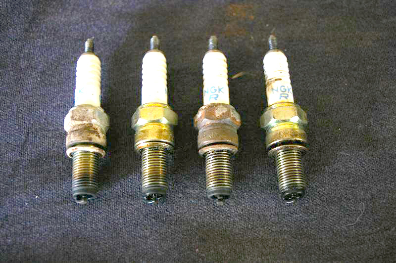

on to the sparks. i'm getting newbies tomorrow morning. i'm pretty sure that'll be most of my problem solved. two of them were actually begining to corrode away, not good!!
If the corroding and carbon deposit wasn't enough reason to replace them, then probably dropping one while taking it out is!!
Yeah, that deffinately tipped the scales right there!!!

New spark plugs in! Bike fine!
Actually its better than it has been in a while. was running a bit rough every now and then and i was also starting to get a bit of vibration up through the tank. All gone now.
