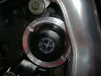

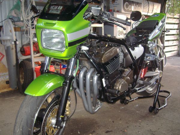

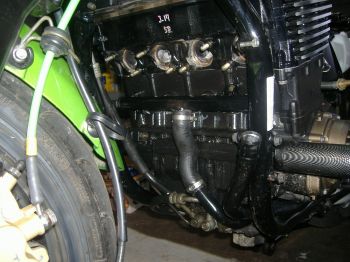

My 2002 Rex is one that has to have the header pipes removed to change the oil filter, this means taking the radiator off to get to the pipes. Alot of work for services. I've bought a Murph's spin-on oil filter adapter and have decided to fit it myself,
for me this is abit of a project.
So far the seat,the tank, and the radiator are off, tomorrow the headers come off and then into the filter housing. Any tips apprieciated.

Getting the Rex up off the ground makes the whole job easier

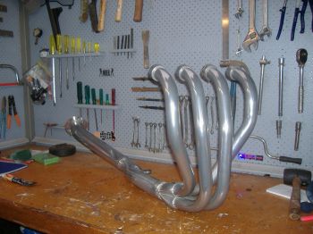

And yes Phil this is a good opportunity to give those hard to reach places a polish
Also the pipes

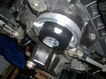

This is the adapter when fitted
Filter changes will now be a breeze.

the job on the Rex is finished,this is how the filter now looks
Oil filter changes will now be a breeze.
