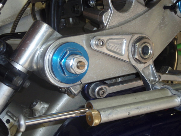

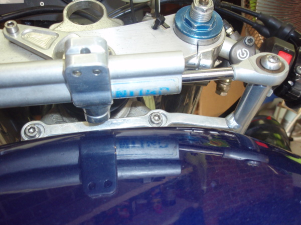

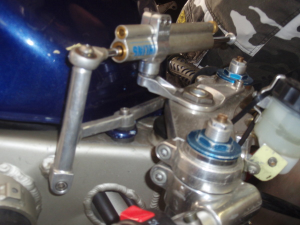

Here ya go Devo
main mount points via forward tank fastening bolts
also a post connected to the tank mount which bolts into the mounting for the H bracket
also screws into the top triple clamp.

where did you get the mount for that one? Also hows the clearance on full lock with the clip ons mounted under the triple trees?

MrWasabi wrote:where did you get the mount for that one? Also hows the clearance on full lock with the clip ons mounted under the triple trees?
Came with the bike Owen, clearance for the post is no problem at the track at least, I also don't have the H bracket on, bike also came with a graves bracket which replaces it.
