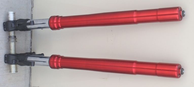

After Philthy pipped me to the post on the 04 front forks the other week I went a hunting for better ones!

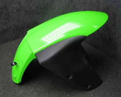

So this is where I'm at at the moment, front forks ordered and paid for, front calipers ordered and paid for. Shipping enquiries on front guard (anybody got a spare one for 05 06 07 or 08?) same goes for axle??
Hel has been contacted for lines :D just need to source the brake caliper spacers, longer caliper bolts and wheel spacers (have the part no. for Kawasaki, just need to bend over and get reemed) requred.
Forks
Forks
Front Forks.JPG (29.61 KiB) Viewed 3177 times

Guard

Nice work Damo, as I said mine were only in good condition ;) The red ones look pretty flash too :kuda:
I should have mine back from getting re valved during next week, then it'll be time to bolt it all up as well, I've got all my parts now - and one other little surprise :twisted: :twisted: :twisted: :twisted:

I have a yellow front guard, that you may be fix up.
its got a crack and a small bit missing.
i'll drop it round.

Cheers Whatster, if it isn't too bad it should fix up.

Are those forks off an 2008 6 or 10?

Special Edition 6 Tim. Black one with the flames :shock:
Should go well with the White black and red scheme.
Just didn't want to end up spending best part of $1200 for something that really isn't going to be stretched on the road, rather just get the best I can out of stock gear.
I know a bloke thats pretty good at setting up suspension also 8)

Damon Z1000 wrote:Special Edition 6 Tim. Black one with the flames :shock:
There's a grey 06 se with flames, and a black 08 se with mirror and red. Different shocks in each one I thinK, although not sure if the 06 were red.
Thought they looked familiar, the nissins are nice!
