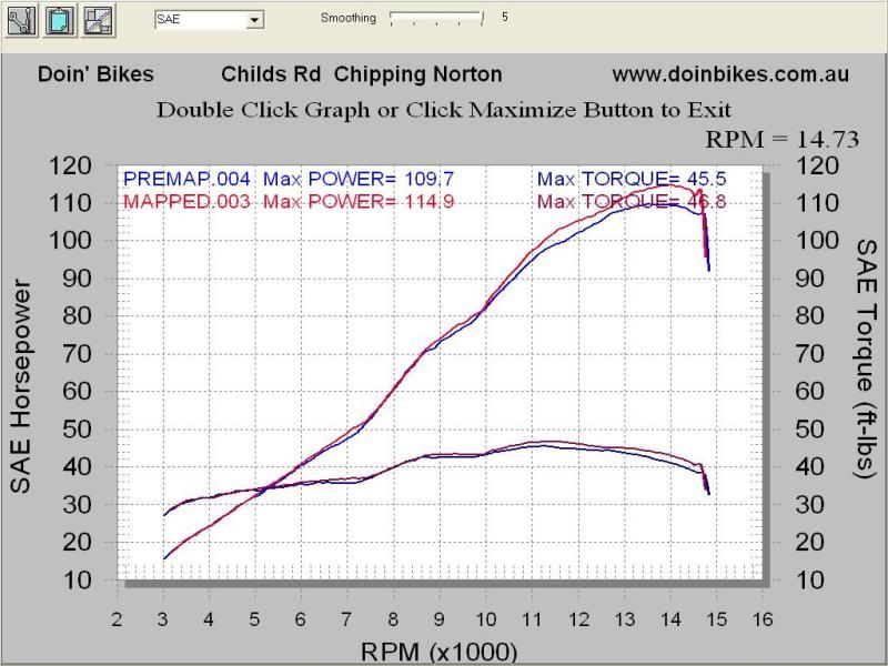

Here is my current map with stock headers and the Akra slip on and race filter.
If i can get it to follow the same increase as i got top end but from 8k onwards i'd be very happy.
