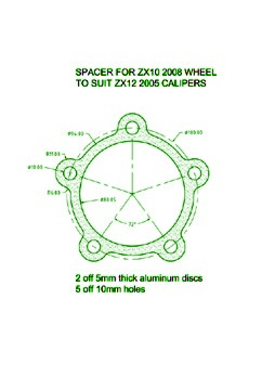

Front Wheel
4 off 5mm caliper spacers outside diameter 24mm and 10mm internal diameter (this accommodates 310mm ZX10 rotor from 300mm standard ZX12 models post 2004, previous 12 models have 320mm rotors)
2 off 5mm spacer plates (attached sketch) as standard rotors on 2005 ZX12 are 150mm outside to outside apart
2 off standard ZX12 spacers length trimmed 8.5mm
1 off standard ZX 12 axle 25mm
ZX10 2008 Front Wheel Hub Spacer to suit ZX12 2005 Calipers copy-2.jpg (572.61 KiB) Viewed 4400 times
Re: ZX12 with ZX10 wheels
Posted: Wed Sep 29, 2010 8:55 pm
by T7 Exit
Sorry about drawing but can't get pdf files across as this was my jpg conversion
