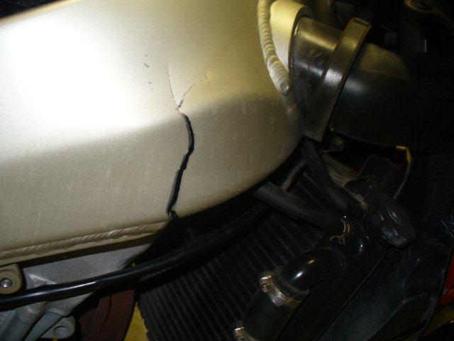

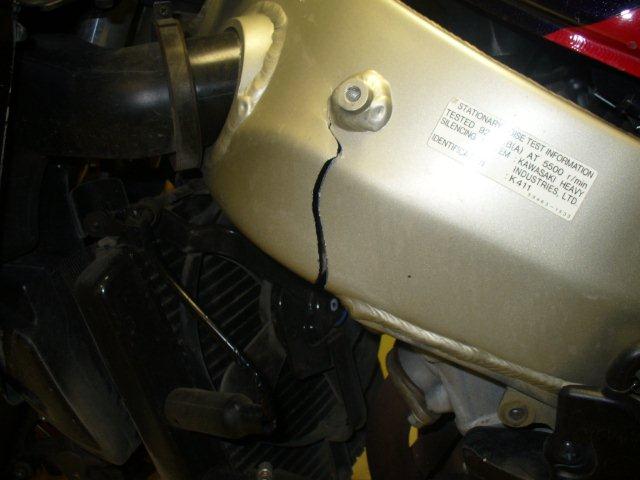

Went for a quick spin to Mornington this afternoon, on the way home I noticed what looked like a crack in the frame just under the tank on both sides.
When I got home I had a better look underneath and took these photos.
I bought this bike with 10,000 k's on it and since then have only commuted to work every day. Now done 37,000 k's. In this time I have probably lifted the front wheel twice. So I am at a loss to explain why this has happened.
Anyone know of any similar incidences?
Has there been any sort of recall on this model (2001 E2 9R)
I'll take it down to John at Mornington tomorrow and get his advice.

:shock: :shock:
2004 ZRX1200R
And it was good
Re: Broken Frame ZX9R
fark!!
only advice i have, is buy a new bloody frame. :x

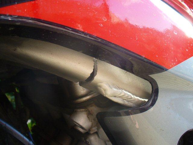

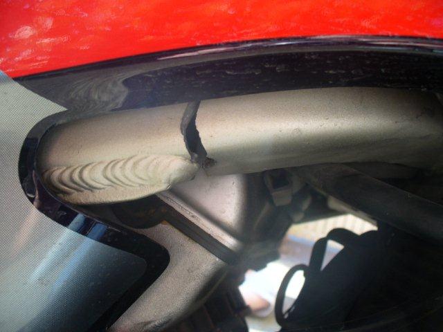

Here's a couple of pics with the fairing off.

Fark mate, i cant believe that, never heard or seen of that happening before, you will need a new frame, not sure how that effects rego though ? Anyone :?

Fark, I haven't seen anything like that. Looks like the fattest bloke in the world has been slamming down some monos. Even though the 9's are pretty tough.
What was the history before you had it?
Did you check everything 3 times, history etc etc

Damn!! That's amazing....never seen a frame cracked like that before..... :shock: :shock:

After a bit of search there have been quite a few in the US and UK although mainly on 2000 models.
also reported on this forum http://www.ksrc-au.com/phpBB3/viewtopic ... 46&t=24579
I'll have a chat to Kawasaki and see what they have to say.
History of the bike is 3 owners, the first bought it to go touring on but after 6000 k's bought a cruiser instead.
The second owner only did about 4000 k's but from the condition of the bike when I bought it he didn't push it very hard.
I have only used it for commuting along the monash with the odd weekend ride and I'm definately not the boy racer type.

The right side crack seems easy enough to understand, looks like a welding issue initiated the failure... the left hand side though seems to have gone in sympathy due to do the increased bending stress.
IMO that's not repairable mate.

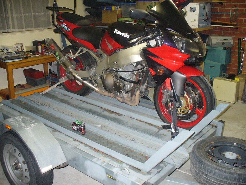

Bike on the trailer to get it assessed.
Kawasaki may come to the party with a new frame, however the cost of changeover is up to me.
This is similar to the stories I read about in the US.
