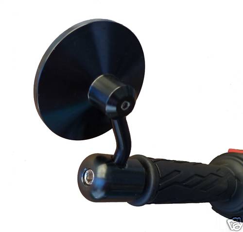

Hi all,
I just bought a set of bar end mirrors for my 2010 Zed and didn't know the bars are welded on the ends for the oem bar ends.The B E mirrors i bought are for hollow ended bars.
Can you buy the B E mirrors without the collets for standard bars, or do you just hack off the collets or the bit on the end of the bars? Any info will be appreciated.

I wouldn't cut the threaded section off the standard bars - if you want to restore to standard.
Post up a pic of the BE mirrors ......... and i may have a spare set that will fit std. bars in the garage ....

I bought them on ebay i think aust sales direct.

i know this is an old post but thoes look sweet does anyone know if they will fit my factory er6n bars?
being broad across the shoulders means i have to pull my arm in every time to see anything behind me its a pain in the ass

If the ER6 use the same bars as ZRX and Z750/1000's then no they won't fit. There are many of us that run bar end mirrors made by Jason7019 on ZRXOA.org that bolt straight up to Kawasaki bars and are easier to see things in than those little ones pictured above. I have had both and there is no way I would ever get the small ones again. Here's a pic of the ones I have now:

I have the mirrors in question (actually have a spare new-in-the-box set) and it required a fair bit of work to get them installed. I bought some allen head bolts of the correct length and thread to fit the bars, and then used a lathe to machine the head down so it fits inside the alloy block in the same way as the supplied bolt does. The extension that sticks out also was machined off flush. They were a mild pain to line up because you can't adjust them with the mirror section installed.
The other option is to use different bars. I changed over to a carbon fibre fatbar and re-used the mirrors. Instead of the alloy spreader you should use some automotive fuel hose. It grips better with a little "give" and still allows adjustment if you push hard enough.
The mirrors are actually quite good for the money. Worth going to all the trouble to fit them.

Jono - there is an internal thread inside the bar. The bar-end bolt is loctite sealed, and will need an impact driver to remove. I have one you can borrow.
You will need to buy a bar-end mirror to suit the Kawasaki handlebar or replace the bar or cut the existing bar to remove the threaded section.
