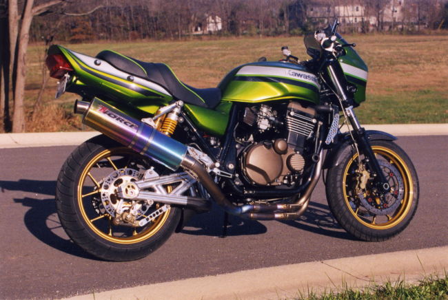

Came across this photo of smoenoes bike (from zrxoa), with a TiForce. :supz:
Schastleevo's bike from zrxoa. Sexy or what!!??

No quality issues as far as I am aware with the TiForce. Greedy has one on his Rex and it looks great, quality is right up there with the Akra / Arata IMHO.
I would get a TiForce over a Yoshi anyday (except in the rainbow colour :vom:) - the way you feel about Kerker's, I fell about Yoshi's :lol:

I could go on with a lot of explanations for all this, but if you look at all the systems on the market, you will notice there a huge difference's in their configreation[spelling] so take note the TiForce system in the pic [to me] looks the best system ive seen so far for the ZRX.. IMO
