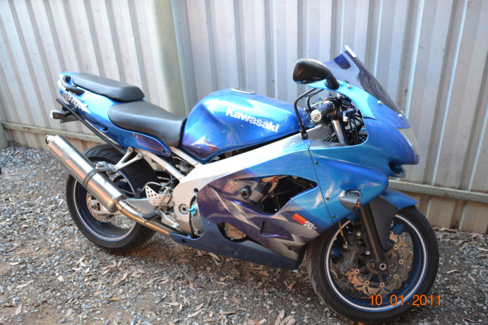

I have a 92 model Zxr 750 i was wondering if a Zx7 motor will fit as i can get one cheap.
Also i know that you can put a Zx9 motor in them i was wondering if anybody knew what year model fits the best???

That would be this one :D

Nope that motor doesn't fit but the previous model one might.
I believe the 93 to 95 zx9r engine is the go.

B series motor or at least the B2 does, I have one but you have to buy the rest of the bike with it I am afraid.

B series will fit. Any 7r engine will fit. I think :roll:

Didnt dave#3's mutant have this same setup? zx7 frame with a 9 engine?

ZXR 750 L engines are the same as J models externally so will bolt straight in (& give you an extra 15+ HP)
ZX7R engines will not fit without a lot of fabrication & modification.
ZX9R B model engines will fit with very minor clearancing mods to the top mount on the cylinder head casting & frame webbing as per MadKaw's link.
Go for the 9 if you can get one, the torque boost is a thing of beauty & you'll be blessed with around 40 more horses than the 750 J & because it's a 9, each one of those horses has the grunt of a Clydesdale & the speed of a thoroughbred Stallion :kuda:
If you do go for the mighty 9 POWERplant, use the 750 L 38mm carbs instead of the stock 40s, tons better bottom end, midrange & throttle response & you'll never notice the 3 or 4 HP you lose @ 10K+ rpm.

94-97, that should be. 96-97 is better, as the clutch spins slower improving the shifting.
