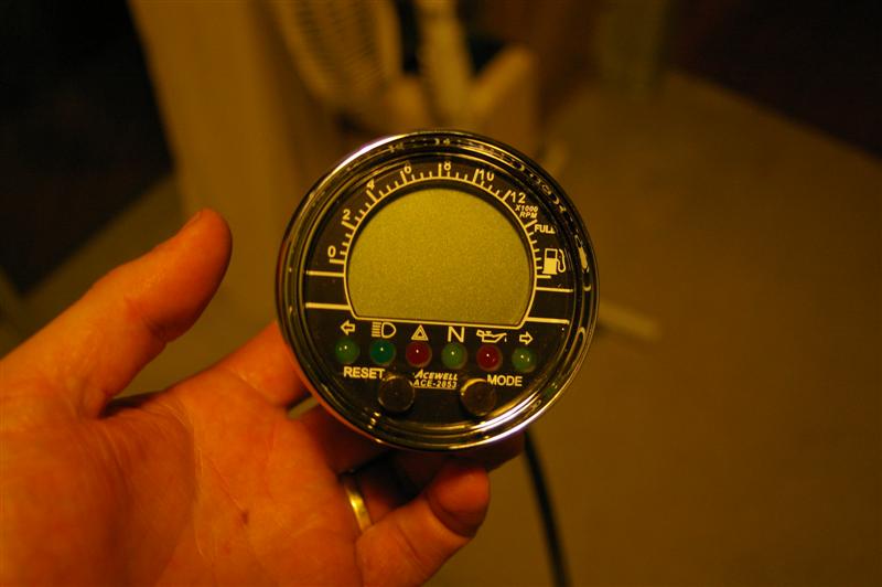

New Acewell speedo arrived today. It'll take some poking but i'm sure that between the factory schematics, speedo instructions, and a little trial and error i'll figure out how to wire it all up when the time comes. :D
It'll be wired slightly differant to accomodate the change from the single indicator dash lamp to dual ones. Also it uses a sensor magnet to gauge the speed instead of the mechanical one. The only thing that the old instrument cluster had over this one is the water temp gauge, but i've got one of them on the way.

Hey Dutchy you can hook up the fuel gauge on the acewell to the temp sender in the thermostat housing so that cold is empty and hot will show full
Re: Time for a change (Dutchy's ZX7R )
Posted: Mon Apr 18, 2011 7:53 pm
by dutchy
oldmate wrote:Hey Dutchy you can hook up the fuel gauge on the acewell to the temp sender in the thermostat housing so that cold is empty and hot will show full
Are you serious?? :shock: That will actually work? :shock: :shock:
Thanks, I might have to try that since i'm not planning on using the fuel gauge.

It works on mine just fine
