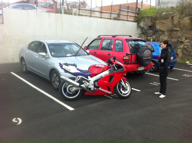

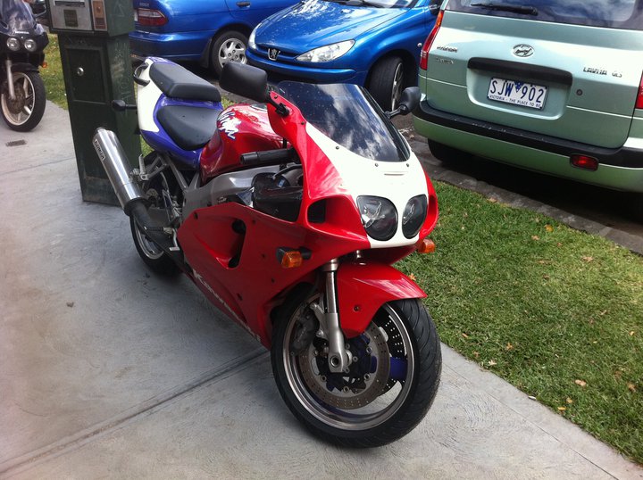

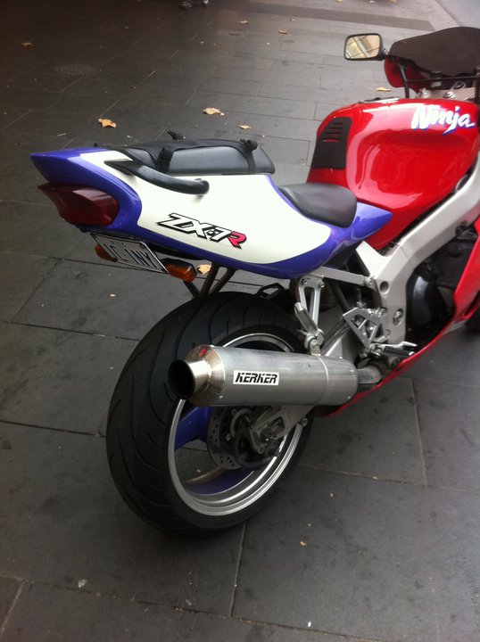

Oh, and here are some pics. I'll have to give it a wash and take some more.
