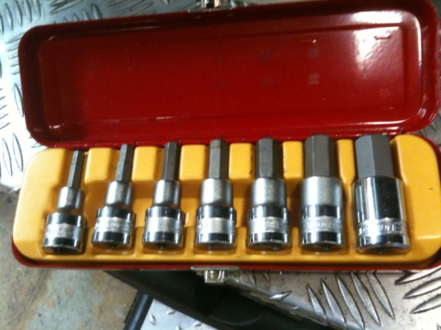

where would i get a allen key/hex bolt that big? its something like 14/16mm and how would i get the tool to fit a impact driver or could i just use a rattle gun?
Engine Mount Bolts Seized
U get those hex 3/8 ratchet Allen keys from an engineering supplier or snap on. That attach straight onto a impact gun
Re: Engine Mount Bolts Seized
Not rattle gun it could possibly damage the hole, go to a specialty tool supplier or see if you can beg borrow steal an impact driver & tool.
I have a Sidchrome hex set which is 1/2 inch drive, same as my impact driver, starts at 6mm, other larger sizes I have here were bought off the local snap on dude.
