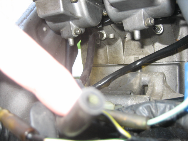

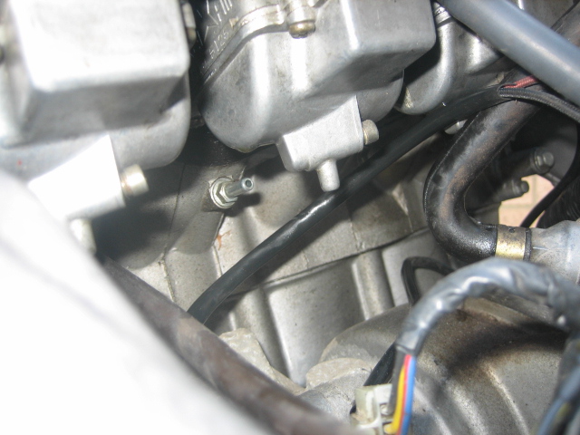

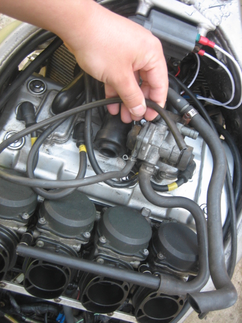

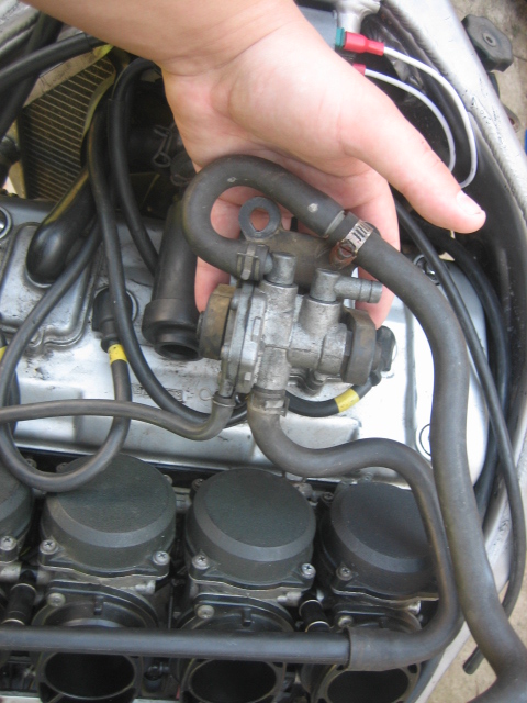

i was going to take the bike to the shop to have this pollution thingo hooked up for around $220 labour i thought i would ask here before i drop the bike into the shop on monday does anyone know where these hoses go exactly and where do these hoses/nozels on the intake manifold go?

i was about to take the motor bike into the shop when my cousin came over he said to drop by a motorcycle wreckers he knew one of the mechanics the bloke was nice enough to take a look he said all the small hoses goto the 3 vaccum ports under the carbies and he showed me where the other hoses goes i will work on it tomorrow and let u all know how i get along also the last owner snapped off the mount that holds both throttle cables this is completely snapped off off of the 4th carbie so i will need to get it welded back on im assuming i need to strip the carbie down for welding?

Mines a 96 model, prob the same, see how u go, i wouldnt be going anyehere near it with a welder, if u got the tank and air box off, easy job getting carbies off.
Suss out the wreckers, maybe able to find a old buggerd set cheap, and rape it for parts u need? not a hard job stripping them, just takes a while!!! doesnt one of those hoses go into the front of the air box? couldnt quiet see enough in the photo

Usually a vaccum hose goes to the fuel tap, and if bike was laying on it side then I wouldn't be to worried if it blowing smoke, but it should clear up after a good run :)

ok guys new bunch of hoses and now im stuck! if i hook the last manifold vaccum hose to one of the two ports on the fuel tank it will either be sucking fuel or sucking air and ive been told the vaccum hoses should suck air or it will seize the engine

I have a 93 model - the 2 hoses side by side on the tap go to the 2 outlets at the bottom of the tank - 1 for the "On" position and 1 for "Reserve". The reason one doesn't leak is because you probably don't have enough fuel in the tank and it's only your reserve hose that's leaking.
Did you get your vacuum hose under the air box sorted?
Pretty sure the manifold vacuum hose goes into the bottom of the air box. I will check over the weekend for you. I should bloody know I've had the thing off that many times :x
