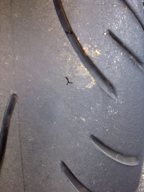

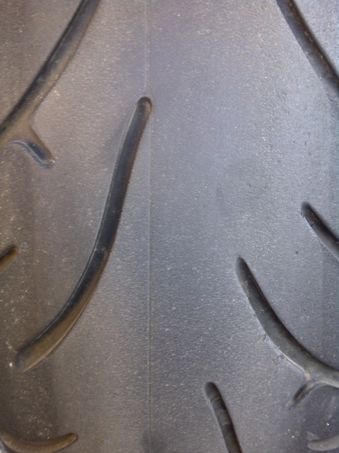

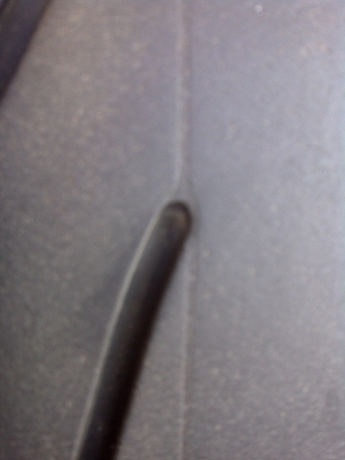

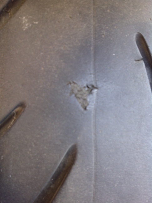

Currently in Burnie Tas, half way through a 10 day tour and late this afternoon while lubing the chain i discovered these marks on the rear tyre.
It appears to be part of the manufacturing process as you can see by the rounded edges of the groove, and the fact that it goes completly around the tyre, with the same mark in each tread.
Have not been doing any burn outs or been on dirt roads, only highway riding. Which by the way in Tasmania is fantastic in a lot of areas.
My main concern is the tyre may be de-laminating.
any one seen this before
Rusty
Close up
Close up

Groove in centre goes all the way around
tyre 2.jpg (127.7 KiB) Viewed 924 times
Other crack
Other crack
tyre 3.jpg (133.71 KiB) Viewed 924 times
Plug?
Plug?
tyre 4.jpg (87.65 KiB) Viewed 924 times

Are they Bridgestone Battlax's ?

if they are bridgestone bt023 its an anti static strip. mine have done it.

by RustyAs
Ahhh..... yes that may help :oops:
It's a Bridgestone Battlax BT023R180/55ZR17M

by kawadave
Mine have done the same.....nothing to worry about. :kuda:

by dilligaf
from memory I've put over 7000k on mine since they appeared so don't worry.
