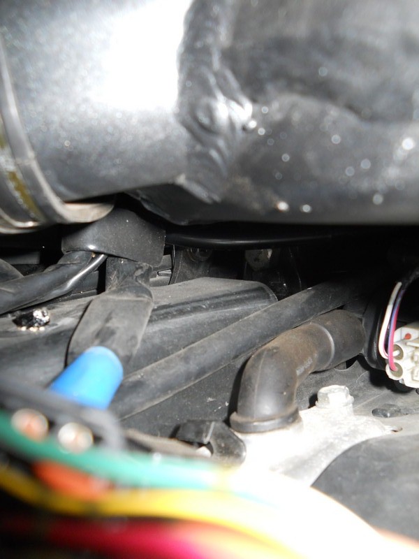

So, thanks Paddo for bringing this topic up, I went and had a closer look and found this......
Plastic guard has been forced up and wire pushed up underneath (blue tape)
wiring rubbing on fan. Bit hard to see but it is the wire with the blue insulation tape
Wiring running under plastic guard instead of over. No clip to hold.
The rubber must have been torn when the mechanic pushed the wiring up where it wasn't meant to go.
After an hour of digging, finally get down to it.
Just cut through the insulation
So, mine was obviously wrong. In to the bargain, two of their mechanics couldn't get it right. The first one that forgot to reconnect it and the second one who connected while I was waiting to get home. So I'll be making a phone call in the morning. Not happy at all.
Thanks for the info Jonno. I don't appear to have the clip that holds all the wires on the left side either. Now I am wondering about the choke cable, which runs between the radiator mount and the frame, instead of outside the radiator mount (3rd picture). Also the radiator overflow line goes through just above my fans (1st picture). Not sure if both of these are right either???
