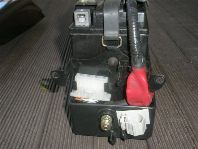

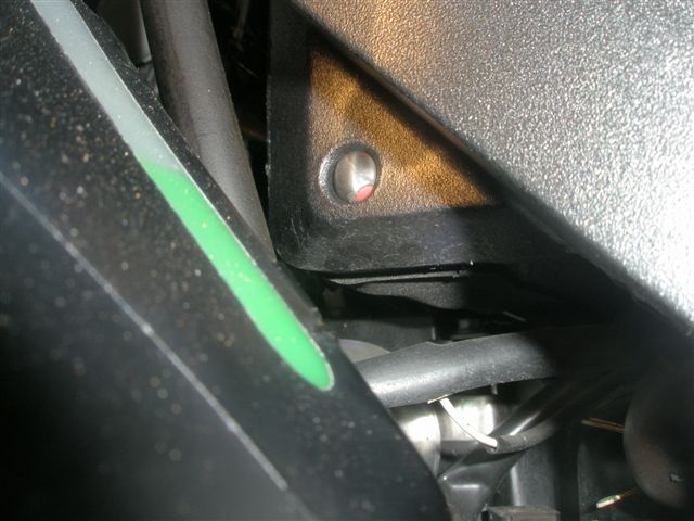

What should you see in the little hole on the left side?
Manual says:
"Confirm that the projection of the battery tray fits into the hole in the left side of the frame"
Mine looks like this:
It just doesn't look quite right to me....

hmmm, didnt know that was there, explains why i have to jiggle it 8) Looks like its hidden under the airbox/tank cover?
if the r/h side cover goes on easily all is good.

I didn't know that was there either wtf. *goes and looks*
Re: battery tray fitting on a 12
Posted: Sun Nov 20, 2011 8:18 pm
by JPaddo
Oh yeah there's a plastic bit sticking out that hole. Yours is definitely not normal.

JPaddo wrote:Oh yeah there's a plastic bit sticking out that hole. Yours is definitely not normal.
Thanks Paddo, that's what I suspected. Will have to pull it out now and see what has been put in wrong.

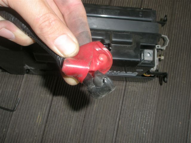

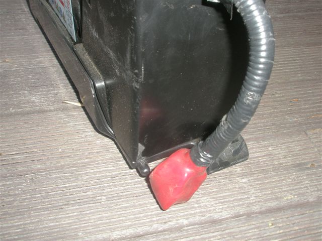

The mystery of what's in the battery box has been solved!!
The jump starting cable had not been tucked under the battery cover and tucked into the battery tray on the right side of the bike. Instead it was jammed in the back of the battery box and no doubt the battery box would have been forced into position when doing up the battery box cover bolts.
So apart from a bit of damage to the rubber cap on the jump staring cable and an hour of my time to install it where it should be(as per the last piccy), all is good again.
