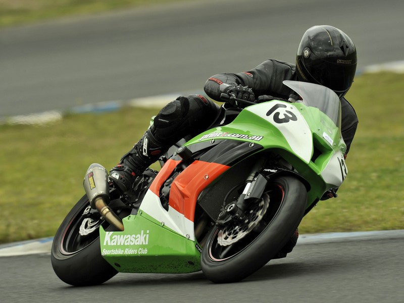

They said the OEM shock on the 2011 ZX10 wouldnt cut it on the track, absolutely correct. Shocking really :roll:
Didnt realise how bad until i seen this pic of it squatting, sags were set and comp was dialled all the way and back a wisker.
Looking through the other JPM photo's in this group no other bike was displaying this.
EC T9.jpg (115.56 KiB) Viewed 2912 times

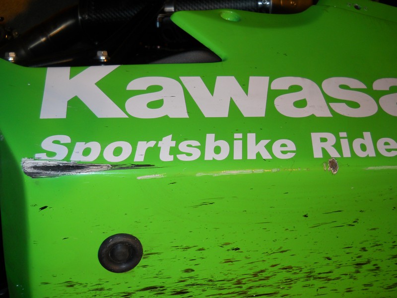

Could feel it scrape a few times, brings back memory's of the 12R's doing the same.
little scratch.jpg (148.49 KiB) Viewed 2912 times

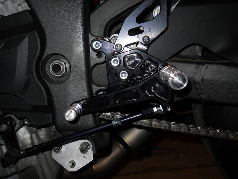

It was being a bit wheelie happy even with TC mode on and my boots were constantly being smashed into the tarmac which effectively had me re-adjusting my line.
rearsets 2.jpg (165.5 KiB) Viewed 2912 times

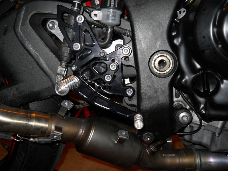

Next: install plastic tube to replace master cylinder.
rearsets 6.jpg (187.21 KiB) Viewed 2912 times

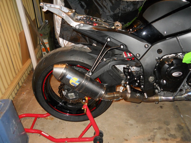

I will remove the ABS fuse as the brakes were quite wooden and a little bit unpredictable in ways when that kicked in, Bendix competition pads go in for a try out.. Was told it is just the fuse, then i have heard conflicting advice so anyhoo give it a whirl and see.
Replaced that brain buzzing Akrapovic shorty with a Leo Vince link and SBK muffler thanks to Maccarocks. Deeper and a bit quieter. :D
rearsets 1.jpg (193.06 KiB) Viewed 2912 times

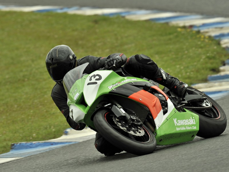

its hows how much the geometry of the bike changes. theres one form the other side at turn 2. the belly pan is paralel with the ground as you are coasting (or little gas) then the one you put up you are rolling on the gas, it shows how bad the squat is.

I agree but for what its worth I wont bother with the oem unit yet, yeah that's the plan then get the bike over to Steve Mudford probably do a Winton TD while there. He is the closest of the highly recommended guys I have heard of, might as well get the best job possible.
Wattie wrote:wheres that other pic Jonno?
Eastern Creek T2
Eastern Creek T2
2 exit.jpg (106.66 KiB) Viewed 2818 times

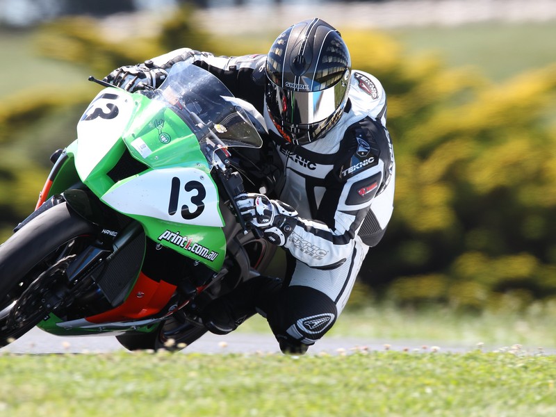

Jonno's bike is a slut :lol: :lol:
another good pic
PI 2011 3.jpg (144.51 KiB) Viewed 2806 times
