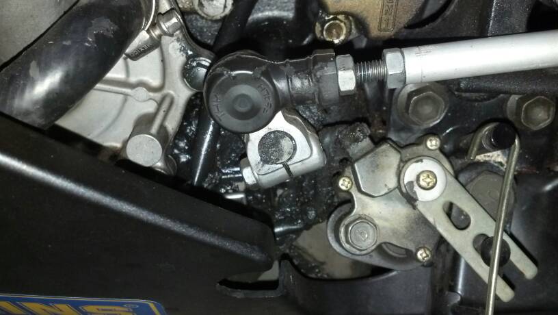

Hello more informed people than me, Down at the island recently towards the end of the second day i began to struggle to get into 6th gear, with and without a clutch. 5th did it aswell but only 2 or 3 times, 6th was nearly everytime. Has anyone else had a similar problem? Im hoping it isnt gear box and that it may have something to do with high speed, but im probably not that lucky. Also is can u wobble the tank a bit? I only just notice mine isnt tight it has a bit of play, bolts are tight.

Take a pic of your gear linkage and post up

When I try to upshift there's mechanical resistance, it isnt slipping on the spline
- uploadfromtaptalk1332399164328.jpg (48.54 KiB) Viewed 5880 times

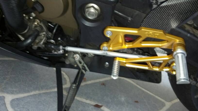

I just put these on, the rear brake got smoked when I lowsided
- uploadfromtaptalk1332399226691.jpg (40.19 KiB) Viewed 5880 times

Would rotating the linkage on the spline so its operating closer to 90 degrees help?

yes!stetto wrote:Would rotating the linkage on the spline so its operating closer to 90 degrees help?
The little dot on the spline, should line up with the slot on the linkage when in street pattern. And 180deg opposite when in race pattern

You could try shortening the rod and rotating the spline to 90 deg, may help.... Can't quite tell from rearset pic but it looks like there is another hole for the rod to mount under the one its in atm. Try that one as it may give more movement of the rod for less movement of the foot..

These rearsets werent on when it was occuring, ill have to check sideways movement tomorrow. Problem is checking it involves doin 250 plus. Hopefully rotating the spline fixes it. Did u ever find out why it did it Glen? Sounds identical
