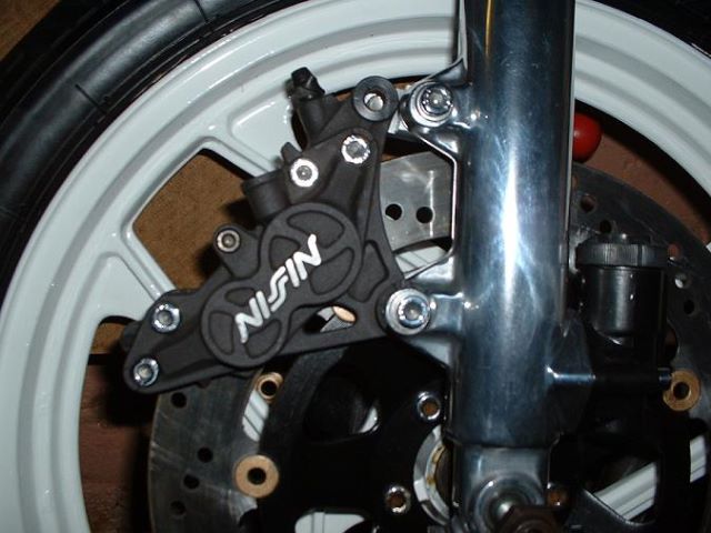

They're a perfect fit Troy. FWIW though, I'm actually steering away from the Tokico callipers on both my 9 and H2 and going with Nissin. I'm looking at buying a set off an early GSXR but I will need to make some adapters so they fit, which shouldn't be too much of a problem. From what I have been reading, they are a shit load better than the Tokico calipers of that era. I just need to find a decent M/C to go with them on the H2 that's period legal.
This is the type of calliper I'm referring too.
gsxr caliper.jpg (49.12 KiB) Viewed 13105 times
