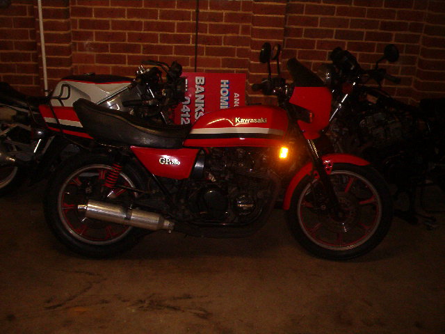

All rego'd now and running fine.
- IM002883.JPG (66.58 KiB) Viewed 5148 times
