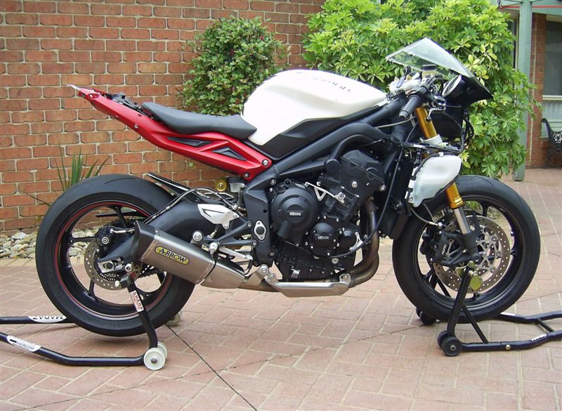

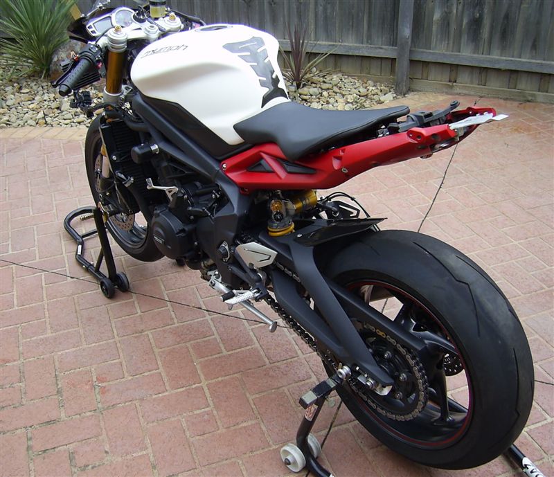

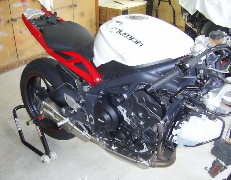

Hi all,

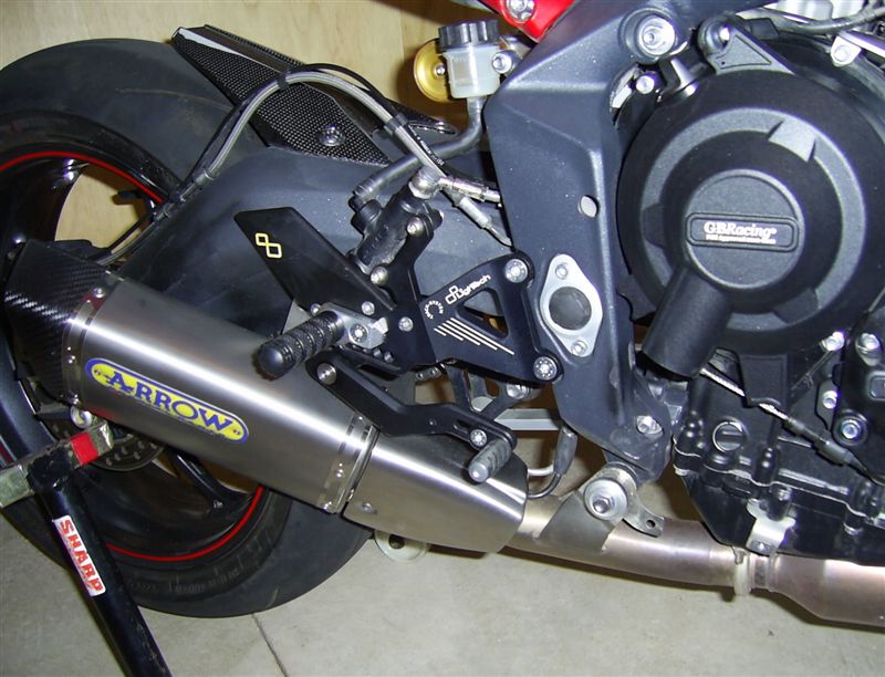

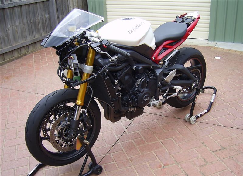

Well it's been a while since my last project, basically because I was concentrating on racing all last year (which does take up a lot of time and money !! :cry: ) But I am back in 2014 with a great new project bike I picked up in early December last year. It is a 2013 triumph 675R. I have rebuilt an 08 model of the 675 and I loved it straight away (some of you may remember the blue one I did) but this one is coming together really well. I cant wait to get it to the track.. :lol:
Only travelled 2000k's. It had a bit of front end damage, mainly 1 x fork leg and the front rim. So I decided to fit a completely fresh front end, both forks (as new just serviced), lower triple, new brakes. It's very straight and is looking awesome. I have already replaced the 'Arrow' muffler, gutted the cat, 'GB Racing' casing protectors, 'Woodcraft' frame sliders, 'Triumph' front axle sliders, 'Triumph' shorty levers, race throttle insert, 'Lightech' rearsets, 'Cox' Radiator protector, full service, new brake fluid, well I have pretty much gone over everything. I will be waiting on the first track test before swapping rear sprockets over as this model has different gearing to the previous one. It sounds awesome and revs so fast, with a new redline of 14,500 RPM :shock: All new engine, Ohlins suspension, slipper clutch, quickshifter.. a full 'supersport' race machine.
Now I am just waiting on a set of OEM decals, and also the race glass to arrive, then will be getting the tank repaired and painted all at the same time with the glass. But apart from that the track mods have all been done. I cant wait to get this bike to the track for it's first run, most probably by February I would guess.. yep I hate waiting, but they say that all good things come to those who wait ;) If you like the look of this one, keep watching as I normally sell them off after a few months... 8) So here are a few pics of the build up to date...

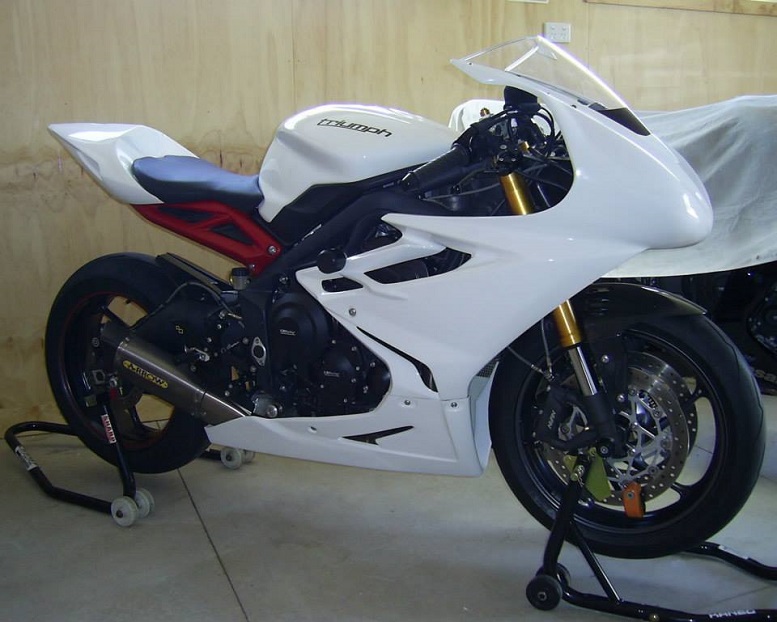

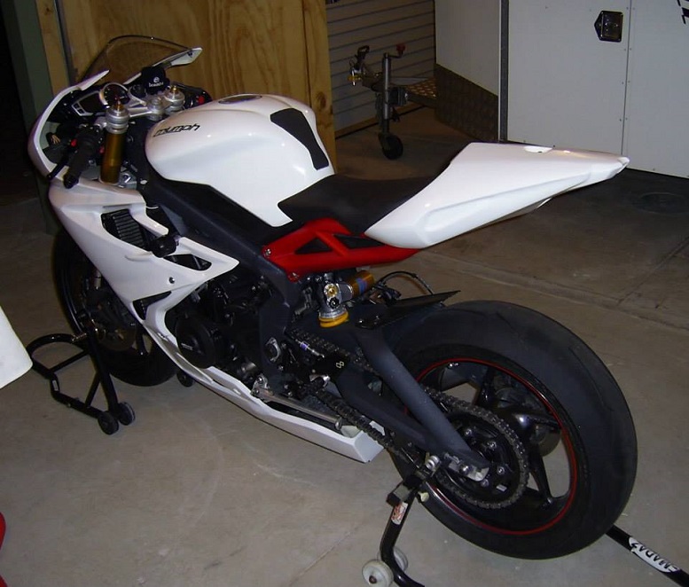

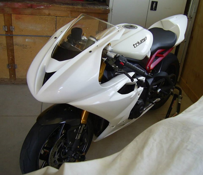

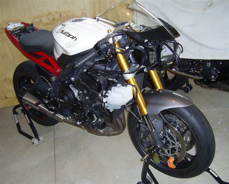

Well the new fairings have finally arrived and the fit was perfect !!
I have been able to get the rest of the track mods completed whilst waiting for them, all electronic updates done, full arrow map downloaded.... Cat removed, exup valve removed, and basically everything done as per my other track-race bikes.. ready for testing Monday / Tuesday at Phillip Island :-)
Standby for a track update and report after this, but here are some pics to date.. not properly finished yet, it will be painted properly after the testing...

Post by Maccarocks »
Yes they are definitely a fast bike straight away...
I tested it at Phillip Island and even though the gearing was not set for the island, by the 3rd session and a few tweaks on the suspension (front end mainly being too harsh) I was heading towards the mid 40's already.. excellent bike :-)
Obviously they are in high demand, so this one didn't last very long and has been sold already to a lucky new owner...
Next project already on the way.. stand by for pics..
