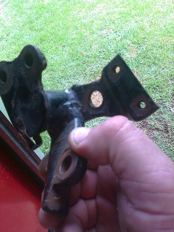

Hey guys I need to draw on the collective brains trust.
Im putting together a GPZ 900 that I purchased in a box.
I have this bracket that I believe is for the centre or side stand to rest on but I cannot see where it attaches. I've gone over my manual and tried to find it online but cant see it anywhere.
Can someone guide me.
Sorry I tried to attach a pic but the photo is too large. I hope someone can figure out what Im talking about and help
Marlon

For what it's worth my side stand and centre stand attach to brackets directly off the frame

I replaced this section of frame on my GPZ that was damaged- side/centrestand mount.
cut frameshrunk.jpg (188.93 KiB) Viewed 26641 times

Sorted. Its a bracket that is fitted when a 4 into 1 relpaces the 4 into 2.
This bracket is fitted to stop the stand contacting the chain.
Now all I have to do is find where it bolts in place.
Any thoughts would be greatly appreciated
