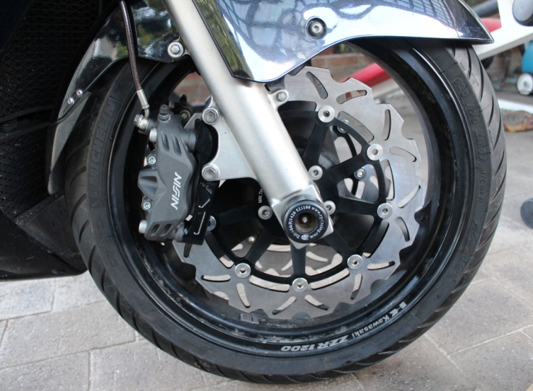

I have always found braking on this bike to be underwhelming and less than satisfactory, even with braided lines, new pads, etc.
Details can be found here (saves writing it up twice).
Fitting took around 20 mins.

Tested.
Faark, what a difference. Night and Day. Chalk and Cheese. The duck's nuts. The ant's pants.
1 finger stopping with these calipers.

I fitted the adapters as prescribed, and attached the Nissin calipers. I did a similar job on my ZRX, no problems.
However, I found when I tightened everything, that the front wheel drags, it does not spin as freely as with the OEM setup. I understand that there is always some drag, but this is a lot.
I loosened the bolts that attach the adapters to the forks, and the drag goes away. When I tighten the bolts, the drag is there again.
I have also tried some washers between the Nissin calipers, and the adapters, and the drag is a bit less, but still not satisfactory.
The disks seem fine, but I am getting them checked tomorrow for any runout.

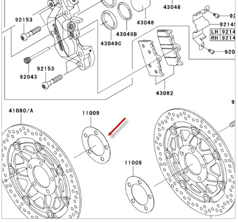

But ... in the parts fiche for the front brakes for this bike, there is a gasket behind each disc. However, it is prescribed for the C3 model ZZR1200 only, not the C1 (mine) nor C2.
In the end I didn't get the discs checked.
I bought and put a set of those gaskets on, and no more drag. Wheel spins quite freely.
The thickness of each gasket was just enough to move the disc ever so slightly away from the wheel..
Even though they are not listed for my C1 model, perhaps these particular non OEM discs (off a ZX12R early model - my OEMs were warped a long time ago) require them.

2. I discovered that one of my (non OEM) discs was warped after all. I didn't notice it with the original Tokico calipers, but certainly did with the Nissins. I think that tolerances with the Nissins are tighter.
So, a new set of discs installed, from S3 Performance.
I did a test ride today, and I was more that happy with the result. After bedding in the brake pads with the new discs, the brakes performed as I expected (just like on my ZX12R I had, and my ZRX1200). Definitely a huge improvement over OEM, and 1-finger stopping.
