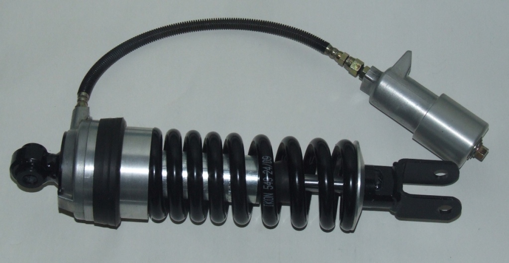

I don't know about rebuildable, but have a read of this.
I emailed them, and they said they could do it for around $800.
Ikon pic:
I was thinking of keeping mine in case I want to do the Ikon thing. I can then send it away while still having a shock on the bike.
Ikon pic:

I went for the Ikon rear shock not too long ago.
I had a few fitting issues.
Fitting......
The top eye is narrower than the OEM one, so Ikon supplied a couple of spacers.
The OEM top bolt does not fit through them. It stops where the threaded bit ends. At that point the bolt has a slightly larger diameter.
I went to my local "Nuts and Bolts" shop, and they had a similar bolt (high tensile) which exactly fits the spacers.
So, that bit solved.
The OEM bolt doesn't fit the bottom fitting either. I drilled the holes out slightly.
The bottom fitting needed attention. It is narrower by a fraction, than the OEM.
The distance has to cater for a fixed width spacer
I bent the ends out slightly, and removed a very small amount of material from around and above the bolt holes. Once attached, the ends pulled together again.
It fits.
I couldn't wait any longer. I went for a ride (it's been over 3 months - shoulder surgery); shoulder actually feels pretty ok.
The new shock feels good, and seems to soak up the bumps better. I adjusted preload a couple of times, and I think I'm close to getting it right.
I initially had the adjuster at 3.5 (had that with the old shock), now back down to 2.0. Damping I have set at #2, and I may drop it down a bit.

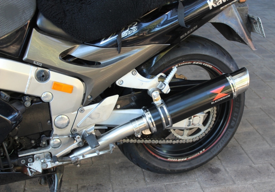

New silencers (Black Widows) are excellent, very nice sound. I have left the dbKillers in, but I chopped off the end caps. It is just too loud with them out.
I just can't get over how good this 2002 bike still is!
PR5's all round.
