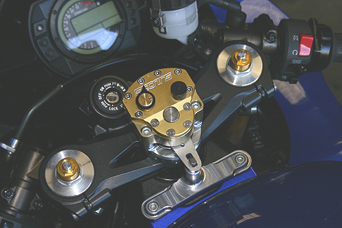

I know two people with '05 ZX10Rs and they both have Hyperpro steering dampers, if that says anything.
It's the type of thing that you'll unlikely ever get use from, but it could well save you from a big off. The thing is... you may never know it saved you as it can avoid a tank slapper to begin with.
I have one on my 10 and wasn't sure how much of an effect it had...until I set it back to zero and felt how unstable the bike seemed to be in comparison. It certainly helps with the feeling of stability through the turns, and as a result my confidence, so I reckon it was worth it for me.
Active and Non-Active...All I can think of is that the Fireblades have an active one that changes it's damping rates to suit the speed the bike is going. This is done electronically. A non-active would be the simple type like mine which just reacts to the bars swinging around when the front wheel is skipping along the road...which happens a fair bit

I have a Matris damper on mine and I think its a good addition. It may not need it but it certainly gives me a bit more confidence.
The difference between active and non active is the active damper has valving that increases the damping rate as steering speed increases. The non active you set at std damping rate. I have a non active and its fine, set it and forget it.. If I'm pushing it around the garage I'll turn it down if I'm on the road it goes up a few notches and on the track a few more notches..
Most late model sportsbikes come with one standard these days and you wont miss them till you need it.
My 046R has one and a lot of people would say you dont need one of these but if you get into it fairly aggressivly at the track in the lower gears over bumpy sections it will start shaking and wobbling at the front and if you dont heed the warning signs it will slap like a beauty.
Mine is a white power and when its screwed right up it provides some resistance but not as much as i think it should i got the actual damper off a web classifieds second hand and havnt got anything to check against to see how stiff it should be when wound right up and think it might need a rebuild which is easy enough to get done at a suspension shop and i can now try it against the one on hemis r1...just screw it up and give the bars a wiggle.
Would imagine a 10r would spend a lot more time with the front end unloaded like not enough weight on the front end because its trying to pick the front wheel up under acceleration so you loose a lot of the stability from the front and it wants to slap, on a 10r i supose you just lift the front wheel straight off the deck.
I put it on because it would wobble around a bit at high speed say over 180kph chasing blokes on 12rs and they where just idleing down the road and it made a fair diference to things in the stability department.
They are also suposed to be a good thing if you make a unscheduled excursion off road through ruts on the dirt and stuff where the front is going to be banging all over the place and your still hanging on.

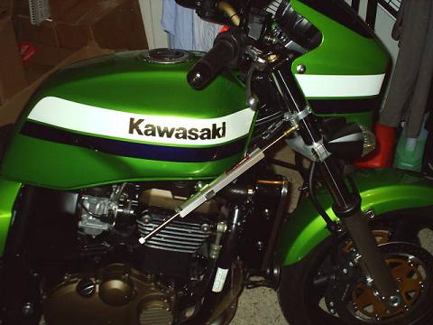

the zrx can get a bit toey when you push it, and it lifts the front real easy due to the high torque of the motor. When I put the damper on it made the bike track through corners better as the steering holds a line alot easier and at high spedd the bike is a shitload more stable as the steering is not twithchy.
Also if you like some extra ride height at the rear of the bike, like I do, to make the big dog hustle a little better, it is a must have as the bike will want to turn in alot quicker and become twitchy.
A must have on any litre (+) bike in my book.
