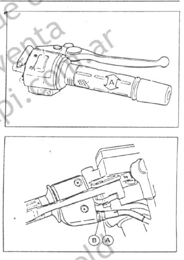

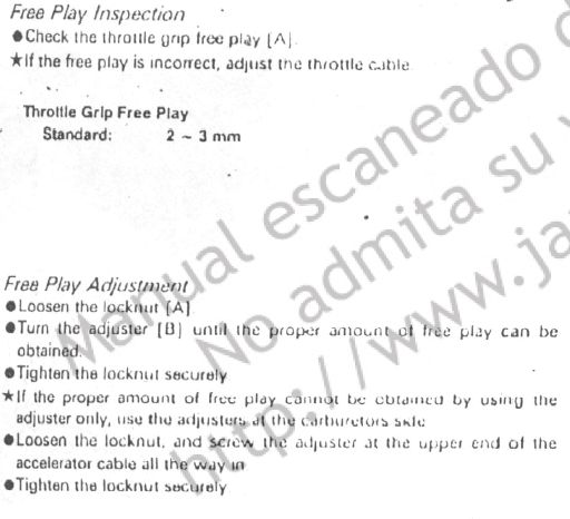

Hey guys, my throttle grip has a lot of play in it (the wiggle before throttle opens), well more then I feel it should. Is there a way to adjust it?

Post by chameleon »
Deserteagle wrote: Is there a way to adjust it?
I adjust mine at the "adjuster" at the end of the throttle cable as it goes into the switchbox on the handle bar. But of course my bike is a ZZR... and your bike is a ZXR... could be different?

Post by chameleon »
Forget it, it aint there. But this is it.

Post by Deserteagle »
Oh what.. that seems pretty easy. Thanks Chameleon.
