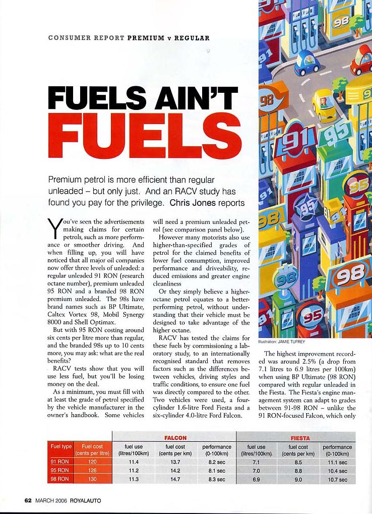

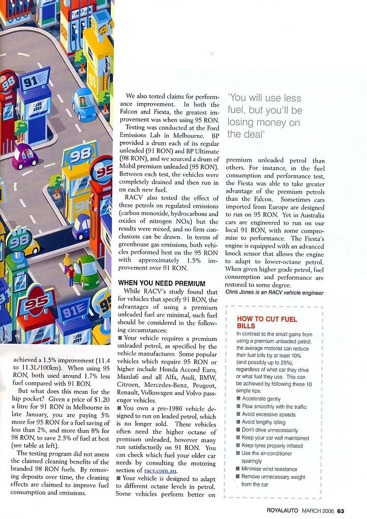

Found this article in the recent Royal Auto. Thought it may be of some interest to everyone. Definatly worth the read if you've ever stood at the bowser and thought "why is this shit 10c more than that shit and whats the diff
Fuels ain't Fuels
Fuels ain't Fuels
Hey people,
- fuels aint fuels 2.jpg (187.61 KiB) Viewed 2432 times
- fuels aint fuels 1.JPG (181 KiB) Viewed 2433 times

Interesting to see the 0-100 was faster on both test cars using 95RON than it was with 98RON. I have to say I can feel the difference between the octanes on the bike. It feels smoother using 98, accelerates harder and revs out more easily. Fuel economy is very similar.

yea i saw it on tv the other nite....altho remeber, sum bikes/cars are designed to run on PULP, and may cause pinging/probs if not run on 98...photomike666 wrote:Interesting to see the 0-100 was faster on both test cars using 95RON than it was with 98RON. I have to say I can feel the difference between the octanes on the bike. It feels smoother using 98, accelerates harder and revs out more easily. Fuel economy is very similar.
However, I find having the exhaust baffle in or out makes far more difference. With the baffle in the economy is better, there is more mid range power and the bottom end feels smoother. Take the baffle out and the power delivery at the bottom end is harsh, mid range looses a bit and the top end gains loads. Fuel economy goes down, partly due to the freer revving engine, but also because the added power gets used moreOh, and it sounds stifled with the baffle in (apparently my bike is a bit loud without the removable baffle, damn I love Staintune).
they also spoke to a few mech's who recommended PULP, but the evidence didnt back it up...and remeber the 95 or woteva it was falcon doesnt have the compression of a 05 zx10r....they mentioned in the article that u should run it on 98ron if specified by manufacturer, and if its a japanese vehicle..

Cars tested were falcoon and fiesta,
it was on "a current affair" in syd, and it stated these results would only relate to cars designed to run on normal unleaded petrol.
