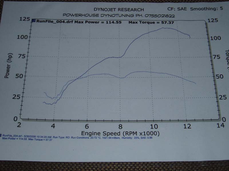

Well picked up my 7 from Powerhouse at Nerang tonight. Ended up putting out 114.5 peaking at 11000rpm approx. A little down under 5000rpm due to race system fitted. I didn't think it would have that much but feels great on the road - can't wait to get to the track. How does this compare to other zx7r 's (I'm not after a chest beating contest but genuinely interested to see how it compares). I know how cars compare but bikes are a bit new. Picture of the graph below if it works. Thanks guys and gals.

It did work and its even the right size - cool.

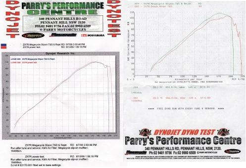

Looks good, just needs a bit of tuning to get rid of the flat spot at 8000 rpm.
My old zx7r put out 109hp and had a slip on and dynojet kit...

Thanks Dave. Yeah it needs some more time spent on it to smooth it out there, it goes through a rich spot at that point. We'll look at that in the next installment (set ignition advancer conservative ATM).

MadKaw wrote:Looks good, just needs a bit of tuning to get rid of the flat spot at 8000 rpm.
as Dave said
and thats not too bad though
...my ol' GeepeeX7fiddy made 105.9hp
with a tune 4-1 and slipon(megacycle)

My old 7R was putting out 113hp at the wheel, this was just a full race system, custom made can and K&N filter, plus the obligatory jet kit. It actually made 116 in one session, but was tuned differently to try to get rid of the flat spot. It still has a pretty big flat spot though, from about 7,000 to almost 9,000 RPM. Which really sux at the track.

nice graph madkaw
many moons ago Parrys had a free dyno day and at the time i owned a ZZR1100 and the ZXR750 H1
they both had a run and both had 2 distinct dips in the power
found the graphs the other day , one day will get em scanned and throw em up

Pretty good Numbers Paul. She'll be a ball on the track 8)
