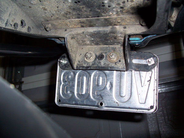

Sorry, been away for a while!
Its not to difficult to do. As Mizz said, all you need is a hacksaw, drill and file. You can actually remove the fender to do this but it does take time to get it off. I did mine installed and it only took about 45 mins.
1) Removed plate. (Good start!), mounting bracket and reflector (reflector bolted on!)
2) Mark lines where you would like to cut. I went along the sides at the 90 corner to where it met under the fairings. The back I just went right between the two flat faces where the plate mount bracket goes and where the reflector mounts. And then I joined the two markings together with what looked like a good shape.
3) The fun bit. Start cutting. (I actually used a Dremel with a small cutting wheel.) Take your time and leave a little room for error that you can clean up later.
4) Once you have your basic shape, I went in with a Stanley knife and file and finished off the shaping. Obviously, the more time you spend, the more professional the look. Use some sand paper to finish off.
5) Once you have finished shaping and smoothing off, take the plate bracket and line it up with the hole from the reflector. Drill a corresponding hole for the other bolt. I actually mounted the bracket upside down as this gave the plate a better mounting angle when fitted.
Bolt it on and mount your plate. AND 'Bobs your aunties live in lover'..........all done.
Here are some closer pics
- 000_0619.jpg (73.4 KiB) Viewed 3504 times

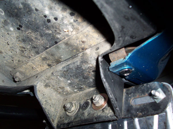

re: Fenderectomy Anyone?
And another
- 000_0622.jpg (59.8 KiB) Viewed 3502 times

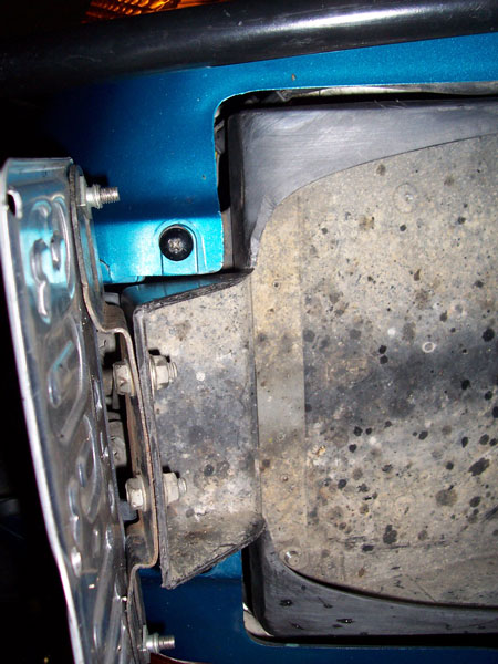

Last one.
- 000_0626.jpg (63.54 KiB) Viewed 3496 times
