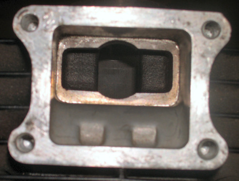

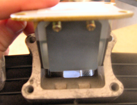

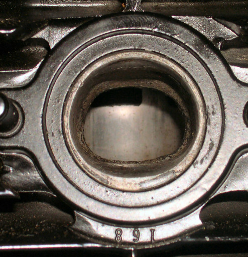

Here's the deal.
The first photo is of the exhaust outlet. The plan was to just get in there and clean up that lip and the shitty surface. Nothing too major.
The second photo is the inlet port. About 2/3rds of the way in, there is a lip, which is supposed to be there. The problem is, it get's in the way of my reed block. The port itself is about half a mm too small on either side, so the reed block doesn't actually fit.
What I intend to do is grind out some of that lip, and widen the sides of the port by about a mm.
Shouldn't be too dangerous if I do that myself. Should it?

Jaseaardvark wrote:Here's the deal.
I guess from your comments...we are 2stroke
1st question..water or aircooled?
2nd..is the engine apart?
coz porting the zorst port will have crap back into the bore
(which will need to be got out)
3rd question.... are you wanting a larger inlet port?
or just trying to fit on oversize reed valve?
4th question...with the zorst port, it looks like the port actually gets bigger
as it moves away from the cylinder edge (out to where the exhaust bolts on)
..or is that an optical illusion?
the reason I ask is.... if the zorst port actually gets larger as it moves away from the cylinder bore,
then I would only smooth out the surface. I would not touch the lip, coz I think its meant to be there
...and without a flowbench or vac gauge, you can't measure the airflow to see whether removing the lip helps airflow.
Otherwise, I would get rid of any sharp edge on the lip, smooth it out
but not remove the lip entirely

Jase - couple of tips to help you out
* you can definitely remove that ridge in the exhaust port. Of course, the barrel will need to be off the bike when you do this;
* After you have removed the lip ( the best dremel tip for this is the cone-shaped one), then you need to ensure that you *radius* the port opening.
You do not want any sharp edges on the edge of the port, this will reduce ring life to buggery.
The best way to radius the port edge ( you are looking for a neat radius of around .5 to 1mm), is by hand, using a small strip of emery cloth. Just work the emery cloth around the port opening, back and forth, as evenly as possible, until you have obtained a neat, smooth edge.
The best accessory when porting is a 'magnifying table light', the kind with a 6" magnifying glass inside a fluoro tube - they allow you to check out the ported surfaces much easier than the naked eye.
As far as the inlet port mods are concerned, once again, you can port out those protruding lips no problem. The reed valves themselves dictate how much inlet mixture is allowed into the motor, and the most important thing on the inlet side is to ensure that the manifolds, reed-valve cage etc, are sealed air-tight. So any minor modification to the inlet passage is OK. As Yoda pointed out, matching gasket surfaces, etc, is the crucial aspect, due to the high speeds of gas flow.
Mate, that reed-valve block looks like you are still using reed-stops ?? Ditch them, and use c/f 2-stage reeds. They don't need stops, and will open further without breaking.....slightly more intake mixture is the result.
Take care when opening out the 'side' of either the inlet and/or exhaust ports - you need to check where the piston rings are 'pegged', so that you don't have a ring 'pop out' into a wider port opening....
Most HP gains in porting 2-strokes are made by lifting the exhaust port. It is important that you don't lift it too high, you can also put a 1mm spacer between the barrel and crankcase ( but this requires further modifications to the transfer ports.....).
NEVER polish the inlet port - this is the biggest mistake most punters make. Polishing the exhaust port is fine, not for HP, but to reduce carbon build-up.
You can double your HP from 8 to 16, you can even go past 16 , but this will need much care and attention to detail.......
Good luck mate !! Keep us posted........I love playing with the ringadingers
