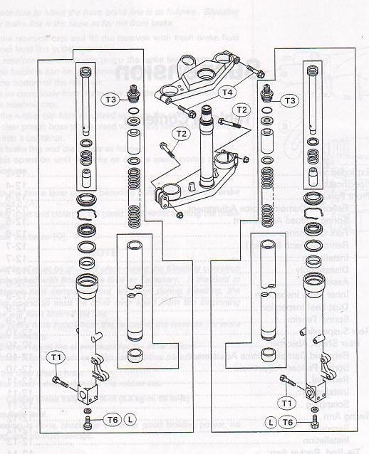

got the manual Bob
fork specs zzr11.JPG (52.57 KiB) Viewed 7637 times
Forks Exploded View sm.jpg (118.52 KiB) Viewed 7636 times
Forks Exploded View ledg.jpg (31.8 KiB) Viewed 7635 times

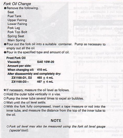

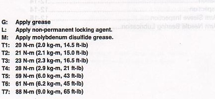

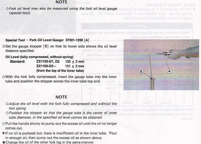

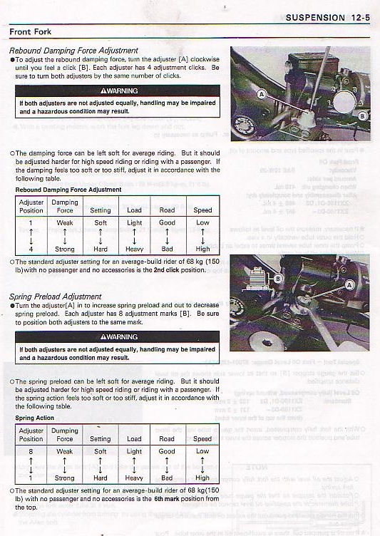

chameleon
Posts: 763
Location: Briso
Post by chameleon »
Some more
Fork Adj.jpg (193.46 KiB) Viewed 7632 times
fork oil check-1.jpg (100.85 KiB) Viewed 7630 times
fork oil check-2.jpg (135.99 KiB) Viewed 7627 times
