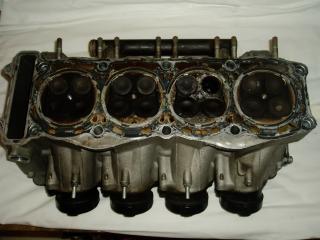

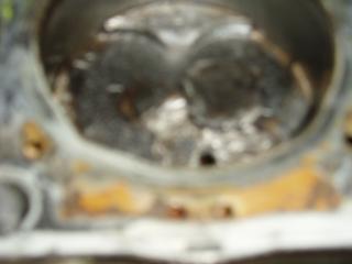

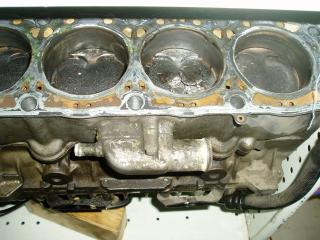

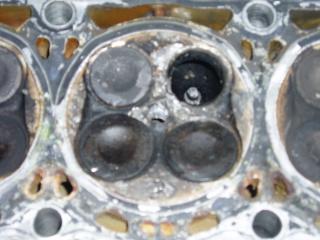

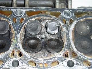

Jpbikeboy and i picked up James Laugesen's old ZXR750 L model engine for engine spares for our track bike project, seeing that jp's 750 motor's gearbox had taken a beating from the turbo, and that he was putting in the 900 for some turbo treatment.
After taking the head off our thoughts of a droped valve were true.
Check out the carnage.
Cheers,
Matt.

Ouch!!! Is the valve train the archilies heel? I have been told that kwaka engines produce the goods, just make sure you respect the revs. I know the kwaka teams have been finding this.

reminds me of when my old gsxr750j had a (very) loose camchain. i changed down one too many gears coming into a corner too fast with two guys on much newer bikes.
the a piston hit the valves and the resultant mess was similar. ouch.

just caught this thread
from experience ....
'dropping' a valve rarely occurs because of high revolutions...
its just that it happens at high engine revolutions
and
is usually caused by -
poor lubrication of the valve stem/guide which results in galling of the stem (the stem will jam in the guide or break)
or
metallurgical failure of the valve due to poor filling of the valve stem (especially zorst valves)
or
a material stress failure due to incorrect valve clearances or incorrect manufacture of the valve.
What is also attributed as 'dropping a valve' occurs when the
collet fails and releases the valve.....
it is my experience that an Ottocycle (4stroke) engine which has proper lubrication and clearances of the overhead valve will normally break something else...
a pushrod or rocker arm or pivot ...maybe a even a valve spring before 'dropping a valve'
hth
