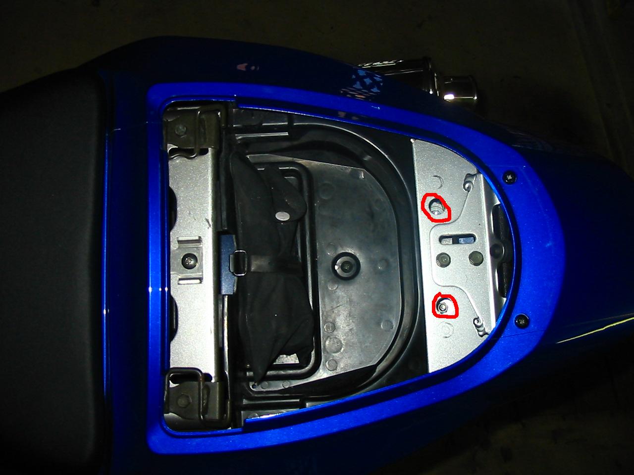

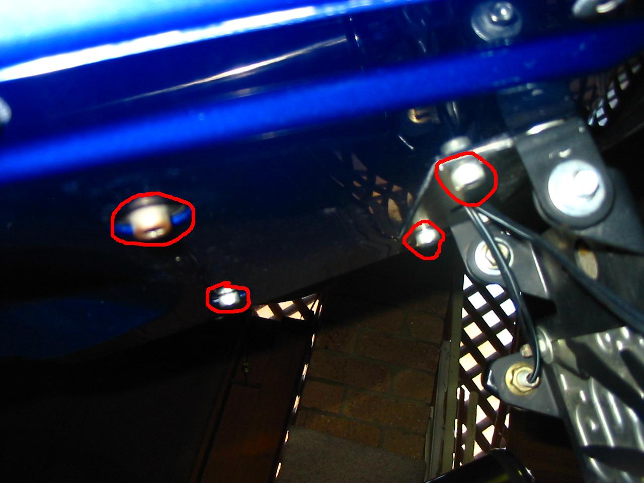

heres my problem: need to remove fender eliminator for roadworthy, but it seems to have the better of me, fiddled around a little bit and decided to not muck around too much until i know what im doing. i cant seem to get to the top of the bolts where the fender eliminator joins the tail, i hope my dodgy paint exercise tells the story.
top view: need to get rid of the storage comparment to get to the bolts - how?

Mate when I did ym 03, from memory you need to remove the whole rear duc tail and then you can remove the plastic tray that holds the tool box to get at the offending bolts....wasn't hard to do as i recall
I agree with Plas on this one... I'm pretty sure the whole ducktail had to come off...
Fark's me how though, I got the shits and went inside and drank beer while my mate sorted it for me.... :lol:

duck tail is pretty easy, front seat off, then follow the screws and push pins 8)

Yep remove the who thing, we had to remove it to fit hubbys ventura rack.
Takes around 10-15min to remove.

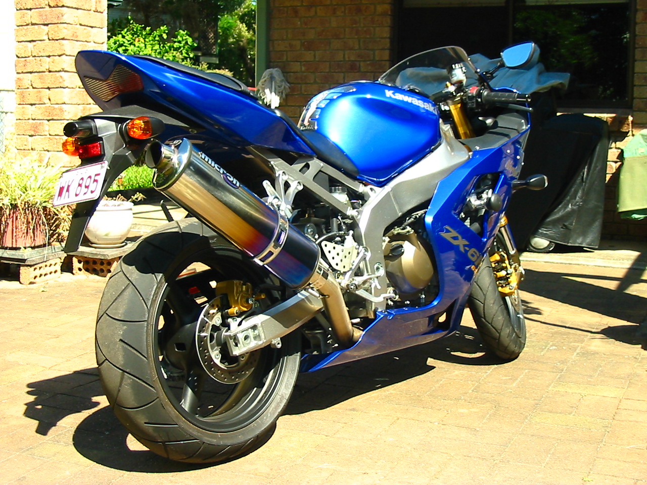

so all is well now, roadworthy is done. dont know if i can be bothered putting the fender eliminator back on, i'll see how i go. anyway here is a pic to satisfy plasmablue636

Thats a good looking bike mate, now rip that huge hunk of plastic of its arse :lol:

yeah get the fender eliminator back on looks much tidier...

nice exhaust
